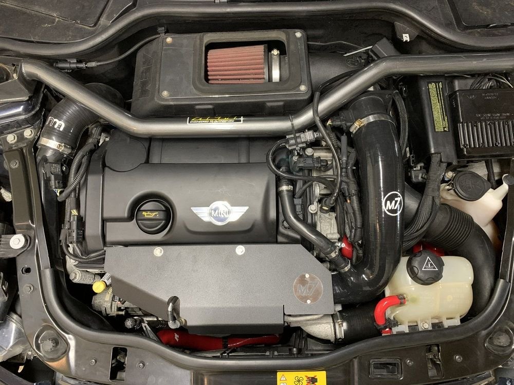

M7 makes a MAF to turbo inlet pipe:
https://m7tuning.com/shop-all/n18-hi...o-choose-from/
I have an AEM intake and then added the M7 pipe.

I have been very pleased with the AEM. Free flow box and filter, and it actually uses the hood scoop for extra fresh air.
