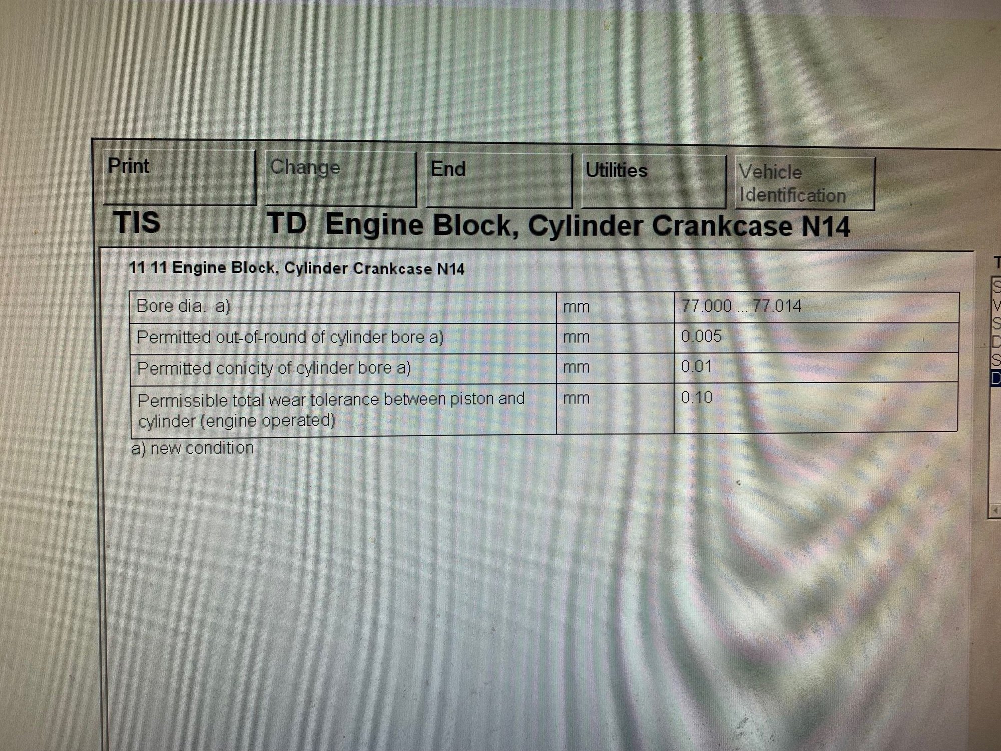

I've looked everywhere and can only find numbers for the R53 crankshaft wear. Does anyone have these for the second gen crankshaft.. I believe the crankshaft is used across many minis 2007+. Thanks.

For posterity's sake:
