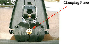

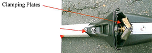

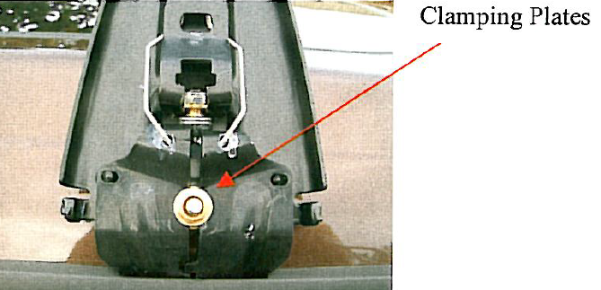

Hello, I recently bought a second hand roof rack; the rear bar seems fine, I can open and close the clamping plates by hand.
However, the front bar's clamping plates are not moving at all by hand. They won't budge and they stay in the open position.
OPEN position: Mini Roof Rack Clamping Plates not moving-128sa05.png
I would like to be able to move them into the closed position which will be necessary when mounting them on the car.
CLOSED position: Mini Roof Rack Clamping Plates not moving-t96lnfs.png
Finally, is there a proper way to loosen the clamping plates mechanism so that I can move them by hand without breaking anything?

The clamps mechanism was rusted enough to seize.
I drowned it in WD-40, let it sit for 15 minutes then I grabbed each plate with a 1 foot vice-grip and after a couple tries it finally became loose again.
