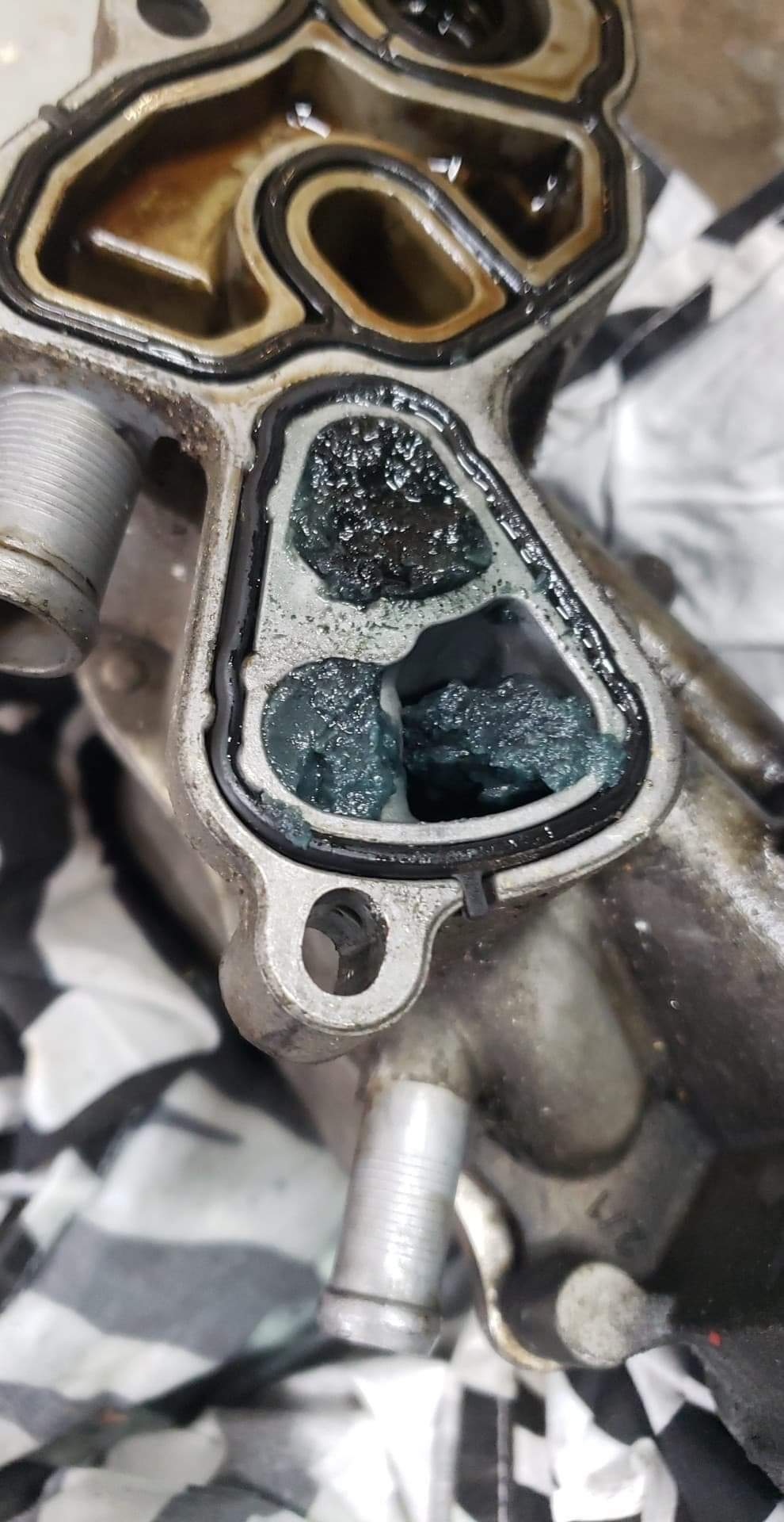

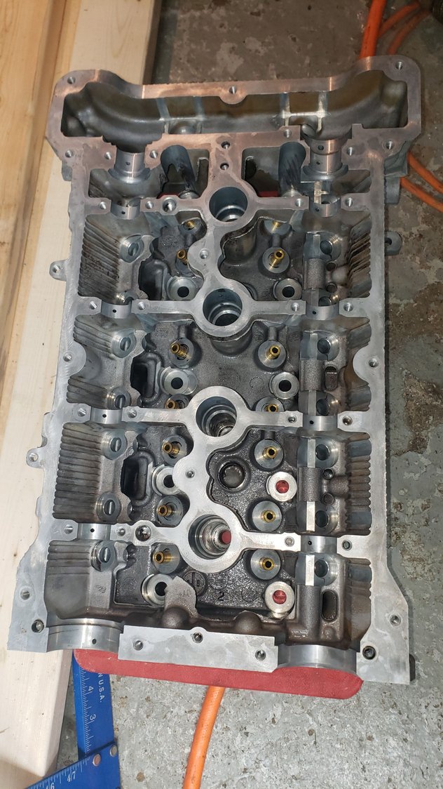

So this is my second post My first of which being in the 1st gear forum and I apologize that its not in the builds forum sectionthat I just found. So...long story short I bought a broke down r56 from a relative to help him recover some $. Ive pulled the engine and trans and have completely dissambled the engine to rebuild. The car needed a head gasket due to the water pipe being corroded and stop leak being used and etc. Etc. So far I've installed new main and rod bearings KING brand racing version completely cleaned the factory pistons and re-ringed with factory mahle ring sets. Ive cleaned the head and all components and awaiting timing set to come in to finish reassembly of this n14. Ive got at least 2k in parts to put into the car before it evens fires back up for the first time. Im excited to get on the road asap and start planning my future payment plans for mods lol. Anyway heres some pics of what I found when taking things apart and how they sit now.
