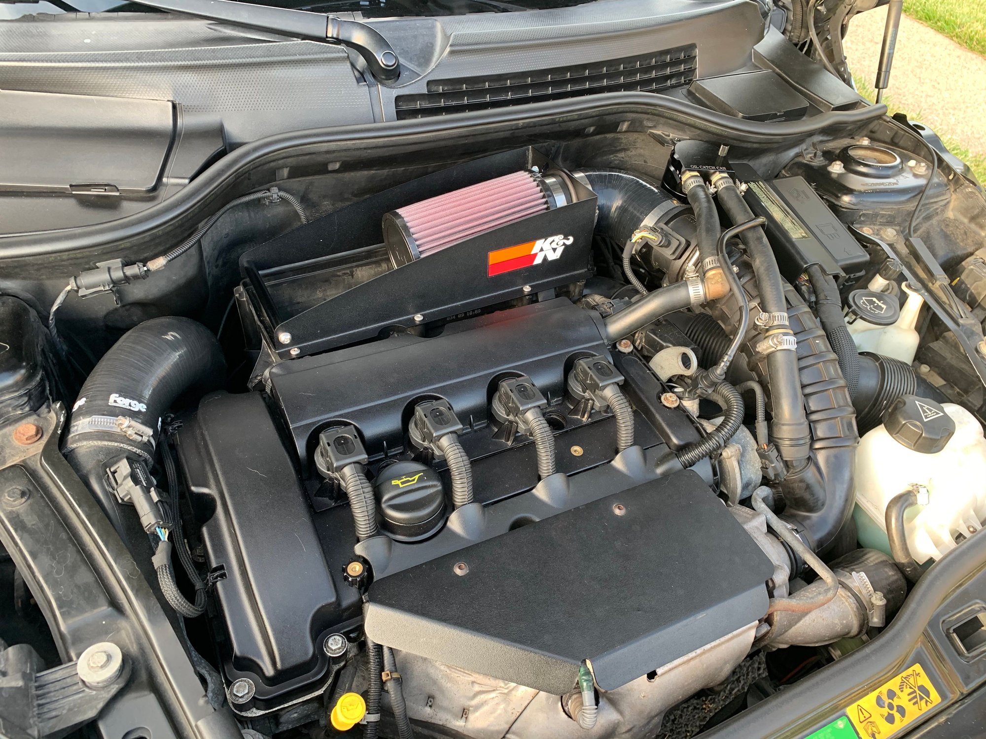

Installed forge bov!
So I finally got to install the forge bov yesterday. The part I was worried about with the aem air box having space issues with the boost tap was correct. The box isn’t flush in the grommets but I was able to get it in the front two grommets (the screw and front right grommet). But it feels secure and isn’t moving.
Installing the bov was very straightforward but removing those bolts was a pain in the butt. I legging spent 30 min removing 3 bolts and another 30 putting them back on. However, I got everything on and it works. I got some loud blow offs and it’s very nice.
I have a question regarding the bov orientation. On the video I saw the guy said the main tube on the bov body points down so that’s how I put it. But they have the other tube point up. I have both pointing down because that’s how it came in the box. Also, after that guy installed it he revved up the engine a few times and you can hear the bov but when I revved it up I didn’t hear much. I only hear it when I drive. Does this have something to do with the bov orientation? Should I put the outer tube pointing up? If so how to turn the outer side up so the forge logo is facing right side up instead of upside down?
heres a link to the video: watch from 3:30
this guy also has the outer tube facing up and his revs are similar to the guy on top:

I’m pretty sure that these only install the one way. I know it looks like a triangle, but those bolt holes only line up one way. As for the sound while parked, you probably are bringing into boost or high enough in the rpm band, but honestly what is the point of sitting there bouncing off of the rev limiter?
lol. Yea I think I installed it the right way but I don’t know if changing the orientation of the outer tube makes a difference. But so far I’m in love with the sound it’s so addicting.

My set up so far
What I’ve done so far...
All that’s left to do is change the downpipe to the cnt racing high flow catted downpipe and add the 3” Alta exhaust or borla s type exhaust. Then I’ll change the rims and tires. Everything I’ve done so far I did myself but I’ll probably have to go to the shop to get the DP and exhaust installed.

I have just the spacer, and I’m pretty sure when installing it the 3 holes only lined up the one way. Taking the hidden bolt out first then the other 2, then on reinstall do the top, but don’t tighten all the way, then the hidden one. I can do the swap now in under 5 minutes.

yea when I removed the stock valve I removed the inner one first then the bottom and then the top. Putting on the forge I went the reverse order. The space is so limited that it’s very hard to get your tool and hand in there to do work. I ended up moving the coolant reservoir a bit just to be able to access the inner bolt. Such a pain but it was worth it
watch that heat shield and your valve cover. There are post where they have melted and got on fire. Honesty I think, and I could be way wrong, but that plastic cover that covers the bottom of the spark plug boots, right underneath your heat shield, if you are not careful with filling up oil, oil can collect under there, the wires are wrapped with a tape that does soak it up a little, and the heat gets trapped there. I have had the wind shift on me when topping off and it just causes me an hour or so making sure I have it all cleaned up. I don’t know who made my heat shield, came on the car, but it doesn’t cover the valve cover as much, and I don’t see any signs of it getting too hot.
Air box has been cleaned out after I took these
I check my oil level at a minimum of once per week or more depending on my drive. My mini loves to drink oil so I’m always on top of it. I have the craven speed dipstick which is freaking amazing. It’s got 10 holes and if your low on oil the holes will be empty. I always keep it 10/10 and add some of it’s down one. You should get one it makes checking your oil a breeze. I also use a funnel every time I fill up to avoid spills and I do in my garage so wind doesn’t sneak up on me. After tipping off the oil or doing my weekly check I always clean off the engine bay and never let any gunk accumulate. The heat shield is very easy to remove so I occasionally remove it and check to make sure everything’s good underneath. I also remove that plastic cover and check the wires and what not to make sure they’re ok. I’m pretty much on top of oil and all other fluids. I also change the oil every 3k miles and use 5w30. I wasn’t always like this. I learned the hard way by blowing up one of the cylinders because there was little to no oil a few years ago. Since then I’ve basically go into a rhythm of babying my car and keeping strict maintenance/servicing intervals along with having it in peak condition at all times.
