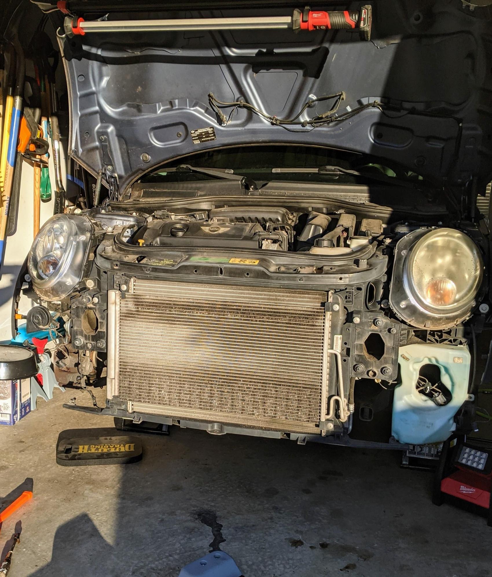

Well, I got started last night. It's kinda funny that the instructions for this kind of thing with a Mini start with "Remove the front of the car as well as the subframe" - lol.
Parts staged: (I'm having to swap out three of the four shocks as they have paint issues exposing bare metal. I don't care about pretty and I don't live in the ruts belt, but am concerned about rust since we do salt the roads here a few times a year and this an "outdoor" car - I was told last night by ECS that it would void the warranty to paint/touch up those spots, so back they go :()
It was kinda funny that the videos and instructions don't mention that the grill comes off in two pieces - the lowest "bar" comes out with a couple clips on each end so you can get to the four pinch-clips to remove the rest of the grill. I figured it out, but obv. would have been faster if I'd known "the trick".
I ended the night deciding to replace all the stupid expansion clips - I had to drill several out and the years haven't been kind to the rest. Since there are 14 in the front wheel wells alone I think I'm going to order 30 of them, hoping to have a couple extra.
I haven't pulled the crush tubes yet - seemed like there was a lot attached there, and I was beat already - lol. As with most "first time" automotive things with me, I think this is going to take a while. Beyond just taking my time, there isn't a great set of R55 instructions, and even the instructions that are out there skip things. I'm figuring it out fine, but it's slow-going. I've replaced shocks/struts before, so that part should go fine (though one of the replacement shocks is on a 2-week backorder :( Going to have to see if somebody has them in stock).
I guess I'll have time to spruce some things up - lol

Spent a bit of time today getting ready to get started on the LCAs - lol.
Crash bars are out - had a bit more to unhook than the Pelican guide said, but whatever.
I was pulling the swaybar links (I'm replacing them anyway) and the nut wasn't coming off with the impact or a ratchet, so out came the weirdo Craftsman "through" ratchet and sockets I usually use when I build struts.
It worked, but wasn't really loving it.
I noticed that I could use my 17mm "skinny" wrench I got for brake calipers to stabilize.
^Why I love roto ratchets.
The Knipex pliers were actually the most comfortable to use, but guessing it wouldn't be this easy when tight.
Net: I didn't realize these wrenches would be this handy for the min. I recommend a set highly...
I was pretty close to getting to the "drop the subframe" part when I realized it was time to get ready for the SuperBowl (though watching the end now, it wasn't a super-fun game to watch - don't really have a dog in the fight). As I moved out from under the car, I wondered if I'll have to drop the exhaust...

Your garage looks a lot like mine....I better make sure you arent in my space.
Which wrenches are those? I use skinny bicycle wrenches for sway bar links sometimes.
I like your long light. Which model is that?
Yes you will need to disconnect the downpipe and the front hangar and let the exhaust hang down to the floor. I hate fighting with the downpipe clamp. Makes me nutty.
Capri - $45 or so on Amazon. I'm sure there are cheaper options, but these guys make some great stuff.
It's Milwaukee's M12 hood light. It's kinda stupid expensive ($199 w/o batteries), though I found a great deal on Amazon Warehouse and already had plenty of M12 batteries. But it's great if you spend a lot of time under the hood:
my (spawn's) much-simpler to work on E53 X5 3.0
I'm over 50 now, and finding that good light is essentially a requirement now :(
Extending the tanget, a cheaper option ($59, also w/o batteries) is thing magnetic guy:
700 or 800 lumens and has a pretty strong magnet on the back!
I figured - no biggie. Going to have to conscript a helper...
