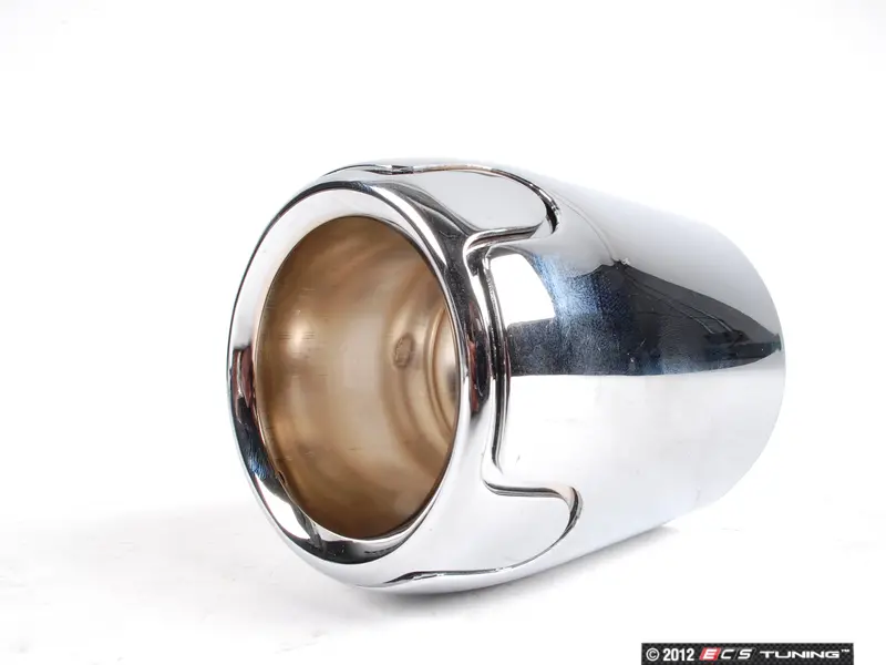

Hello,
https://www.ecstuning.com/Mini-2007-...A/Exhaust/OE/4
MINI had these other tips that are for the stock Cooper S exhaust to swap out. 18300445381
Otherwise we have universal ones that will require a sleeve clamped or welded to step up the connection to fit the MINI OEM exhaust.
https://www.ecstuning.com/Mini-2007-.../Exhaust/Tips/
