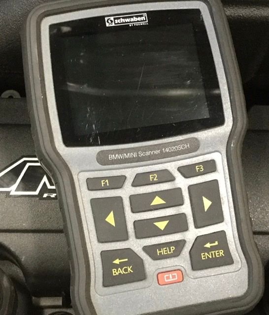

key in, ignition on, car off (tac, lights dash etc lit up)
fire up scan tool, go in and clear any dme’s (codes)
go back and reset adaptations.
on a Schwaben tool, prompts are cryptic, and dont tell you what to do other than car must be in park for auto trans. And some things about a terminal change and terminal 15
i had the e-brake on and in gear though.
As it resets you hear the clicks and wizzes coming from the engine bay as things reset.
30 second count down which goes so fast its about 10 seconds, but i waited the full 30 seconds.
screen comes up and tells you something about terminal 15 and wait 15 seconds.
i waited 20-ish
pull the key out so nothing is on.
hit ok, and done.
i waited another 20 seconds or so
Put the key in and ignition on.
i waited about 20 seconds.
Go into schwaben, clear any codes/cel’s
fired car up
let it run for 5 minutes
depending on your scan tool some of the code related verbiage may be weird to you, this might help.
the Foxwell/Schwaben tool uses the words Terminal 15 but nothing anywhere tells you what that is.
your took may be very simple and straight forward, not sure.
Terminal R = key pushed all the way in and locked
Terminal 15 = key pushed in + tap the start/stop button so that all accessory functions turn on but car doesnt start.
"terminal" references are:
helpful tip
if you do this and run the car after wards, then shut it off and the radiator fan stays running and rather loudly too, you have done it wrong.
the "ignition on" statement is very frustratingly weird for a car with a key fob you push in and a push button start.

Okay, I followed Exdos instructions because I have the BaviTech Enthusiast version scanner, but after searching the drop down menus, I cannot find anything that says re-set adaptations!!! Am I just missing it, or does this scanner not have the option to re-set the adaptations?
HELP!!!
HELP!!!
HELP!!!
HELP!!!
you would have to call bavitech or look around forums to know if it can do it.
also looking at a few other threads from you posting similar comments have you even tried reaching out to Bavarian Tech?
their own website doesnt even show the 2010 mini as a supported model. It stops at 2008. I say that as i saw a post mention you have a 2010.
