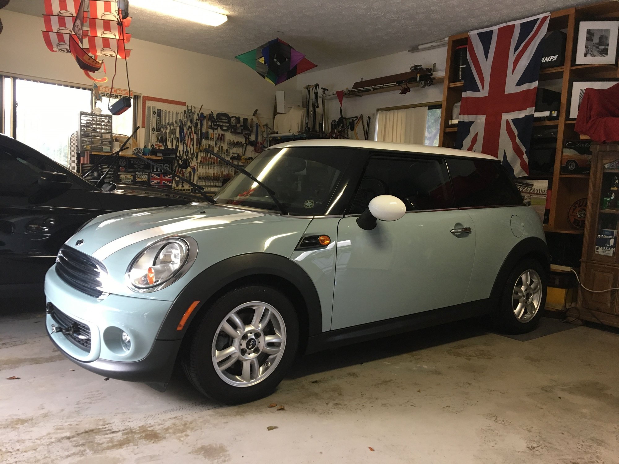

Hello! Been around since 2003 but its been a couple years. Just picked up our 6th MINI, a 2013 Cooper automatic, this one for my daughter who just graduated high school. Cosmetically it is nearly flawless, and mechanically it seems like it is in really good shape. It has 105,000 miles on it, but only two owners. The second owner put 70k on it in 3 years making a very long freeway commute. Has good records and just came out of CPO warranty.
I'm going to do an oil change, change the spark plugs, air filter, and go from there. Daughter is already googling bonnet stripes and a bluetooth dongle to get the music playing through her iPhone.
Its been 4 years since we had a MINI - is there any other maintenance item that MUST be done at 100k on an automatic r56 Cooper?
here it is sitting in the garage with a couple of other British vehicles....
Awesome, welcome back. Nice garage set up, Clean.
Congrats on the new baby! We recently picked up our third Mini (a 2013 ice blue MCbase with only 26K miles). Can't help much with your ask other than it seems reasonable but I'd definitely swap that long aerial our for a short one (I used the OEM Mini shorty). I just went through replacing the base on mine due to the long aerial catching on something and busting the base. Also swap as many lamps as you can with superior LEDs (at a minimum, the headlamps and driving lamps). Yup, bonnet stripes are in order. Like your Bonneville and Tiger (?); I enjoyed a carbureted Bonneville and Speedmaster among other bikes during my previous riding career. Quickly gave up trying to clean off the 'liver spots' on the headers.
