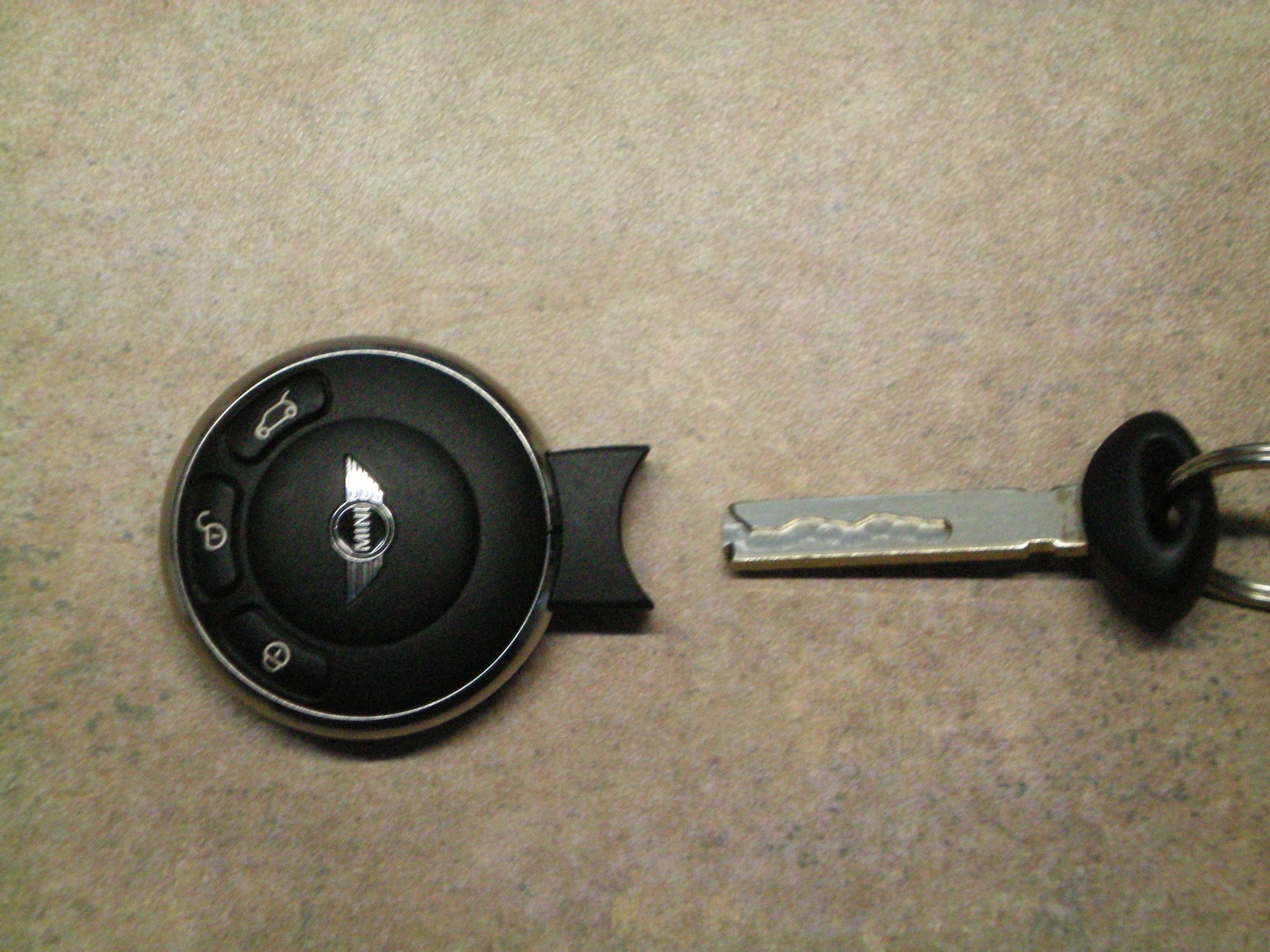

I'm confused please can someone explain me the difference between the two fobs. btw my car doesn't have comfort access.

.................................................. .............FOB.................................. .................................................. ....................... KEY INSERT
FOB starts the car and has button for locks. Key provides a 'backup' way in if the battery is dead ... you can unlock the driver door. Key fits into the FOB (lil silver button on FOB to release the key.) It is possible to lose the FOB and still have the key. (OOOPS)

That’s it right there. If you need to replace the fob, but still have your cut key, you can just get the fob and reuse the key with it, and save a few bucks.

Sorry guys English is my second language. Do I really need the key insert ? I lost the original fob with the key insert. I have an extra fob(key insert is uncut) that my friend programmed but it only opens/closes my car but it doesn't start my car.

Adding 1 more info. The guy told me the more expensive one have the rechargeable battery the cheaper one doesn't. I'm not sure if his BSing me about the rechargeable. If it's true can't I just change the battery on the cheap one?

That’s true, the comfort access fobs have a replaceable battery, the regular fobs do not, they recharge while inserted in the slot while the car is on. That cut key is an emergency backup to unlock the car in the event that the fob battery dies. The immobilized chip is in the saucer part. And cannot be programmed as far as I have found. It can only be purchased from the dealership.
