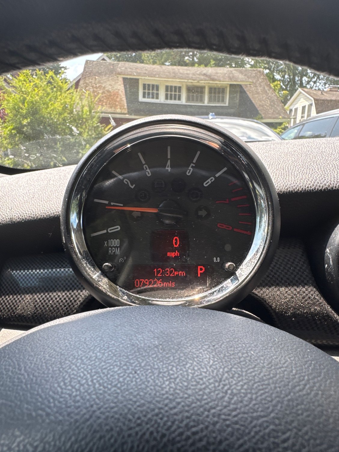

I just did this to my R55. I can confirm the ISTA+ method works for my car, no more check control for the clock! Main struggle was finding and installing ISTA and BMW standard tools. Once you're in the program, go through service functions to registering a new battery, and during the process the date and time will be set, no need to actually register a new battery or anything. The clock actually shows in the tach now too.
clock is working!
