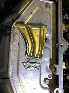

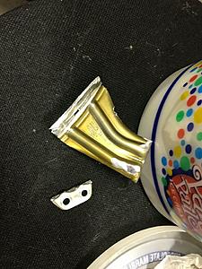

New here and hoping I'm posting in the right place.
We have a 2009 base model that I had to get a new valve cover for because of PCV problems.
When I took the old one off, I found the upper timing chain guide broke off and just sitting there getting grinded by the cam gears.
Have no idea where the plastic piece went.
Getting the new timing chain guide Tuesday but I can't find torque specs anywhere.
I need the torque specs for the 2 little bolts that hold the timing chain guide on top of the head and also the torque spec for the 13 bolts that hold the valve cover on (I believe 7.3 ft-lbs but not sure).
I really appreciate the help.
Attached Thumbnails Torque spec for upper timing chain guide?-37053619_1295023160635219_6850280628743569408_n.jpg   Torque spec for upper timing chain guide?-37043743_1295023087301893_1440149203463438336_n.jpg   Torque spec for upper timing chain guide?-37070663_1295023183968550_1204155572480376832_n.jpg

Bentley manual, pg 117-26 has a pic of a guide matching yours with a spec of 20Nm (14.7 ft/lbs) for M8 bolts.
