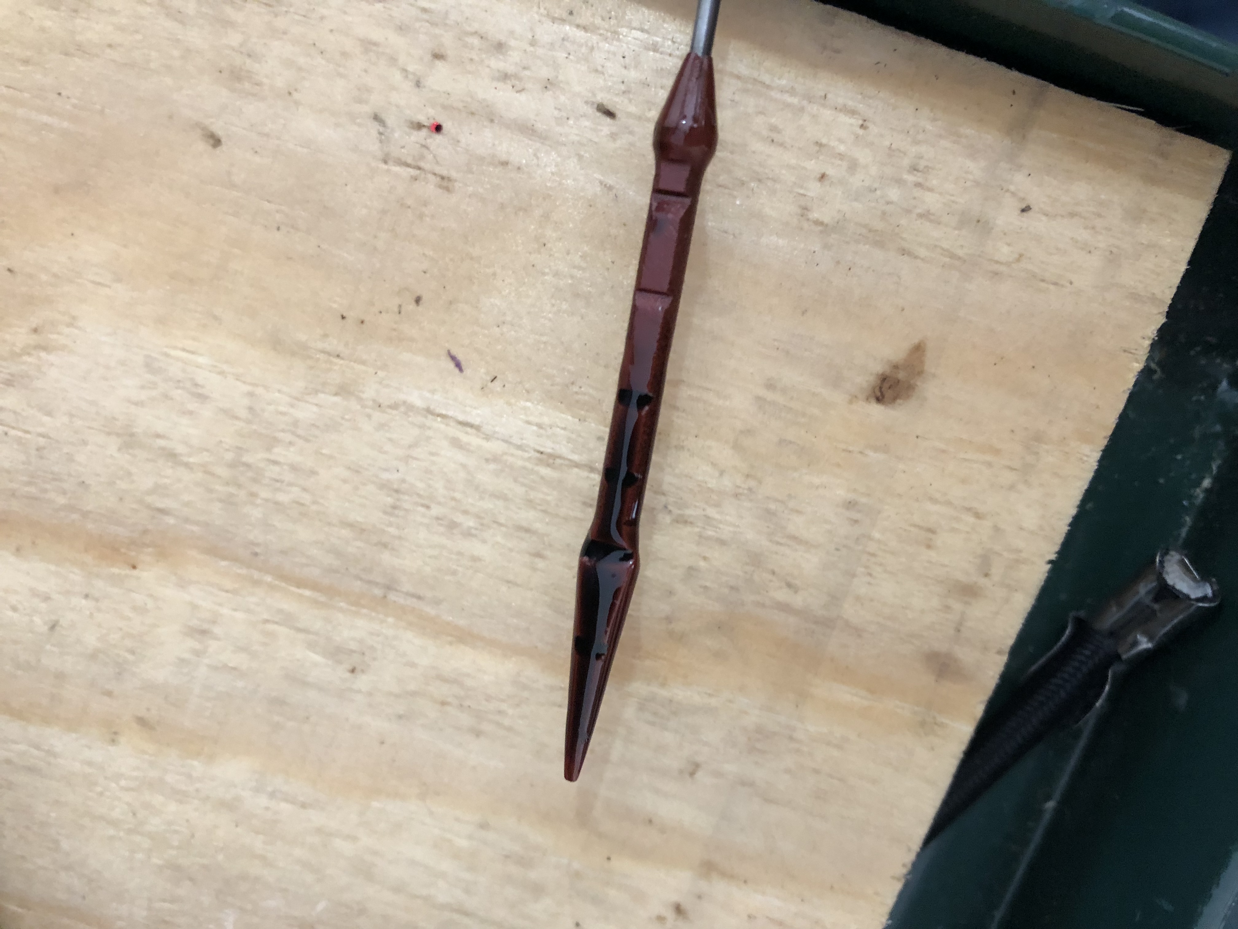

I chose to follow the directions from one of the post here and altered my dip stick to include groves to make it easier to read. Just take a flat file and carefully shave down one side, then use the edge of the file and cut some groves in. The groves will pick up the oil and give you a better view. See attached picks.
Hope this helps
Hope this helps
thats awesome!
