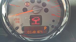

Just got this warning light , a red circle with the exclamation mark, Mini on the hoist and the code CC-ID 071. Google search comes up brake wear sensor. Am I right ?

You got me there but this is a good video showing you how to replace the pads.

I realize I didn’t answer your questions.
Yes your mini uses the same brake pad for regular braking and the parking brake. There is a mechanism in the caliper that adds mechanical pressure when the parking brake is engaged.
No it is technically not the same as replacing the whole parking brake assembly (cables, pivot arm, caliper and retaining but) but that doesn’t seem to be your issue.
A warning light for brakes is either to do with a scheduled maintenance or a wear sensor indicating low pads.
Grab some new ceramic pads rotors and sensors for around $250-300 put em on in your driveway with a friend and you’ll have something that will last, look a lot better and most importantly stop better.

I knew I need to replace both the front and rear brakes because I got the warning signal.
As of Saturday , the computer show front brake has 1400km and rear brake has 400km left. Also, brake fluid flush due this month. Come Sunday, rear brake was at -100km. I didn't even put on 50 km between Saturday and Sunday and it goes from +400km to -100km.
Today, the red circle and exclamation stay on even after I disengaged the parking brake. That's why I thought I have a problem with the parking brake. But after reading the owner's manual and did some research online, I think I just trigger the wear sensor for the red circle/exclamation to stay on.
