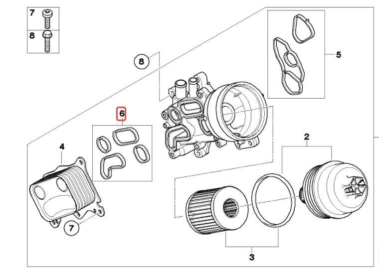

Should I replace the turbo oil line just to prevent a future slow leak or can the turbo line seals burst suddenly causing catastrophic failure? I'm a little short on cash now so I'm mostly focusing on stuff that can cause catastrophic failure / leave me stranded.
Did you replace both 5 and 6 in this diagram or just 5?

Regarding oil cooler gaskets:
Replaced 5 and 6. Also, you may want to blow the channels out in the cooler (the stacked finned assy #4) in diagram. For some reason I had gunk build up in the cooling portion (there is separate oil and coolant passageway).
