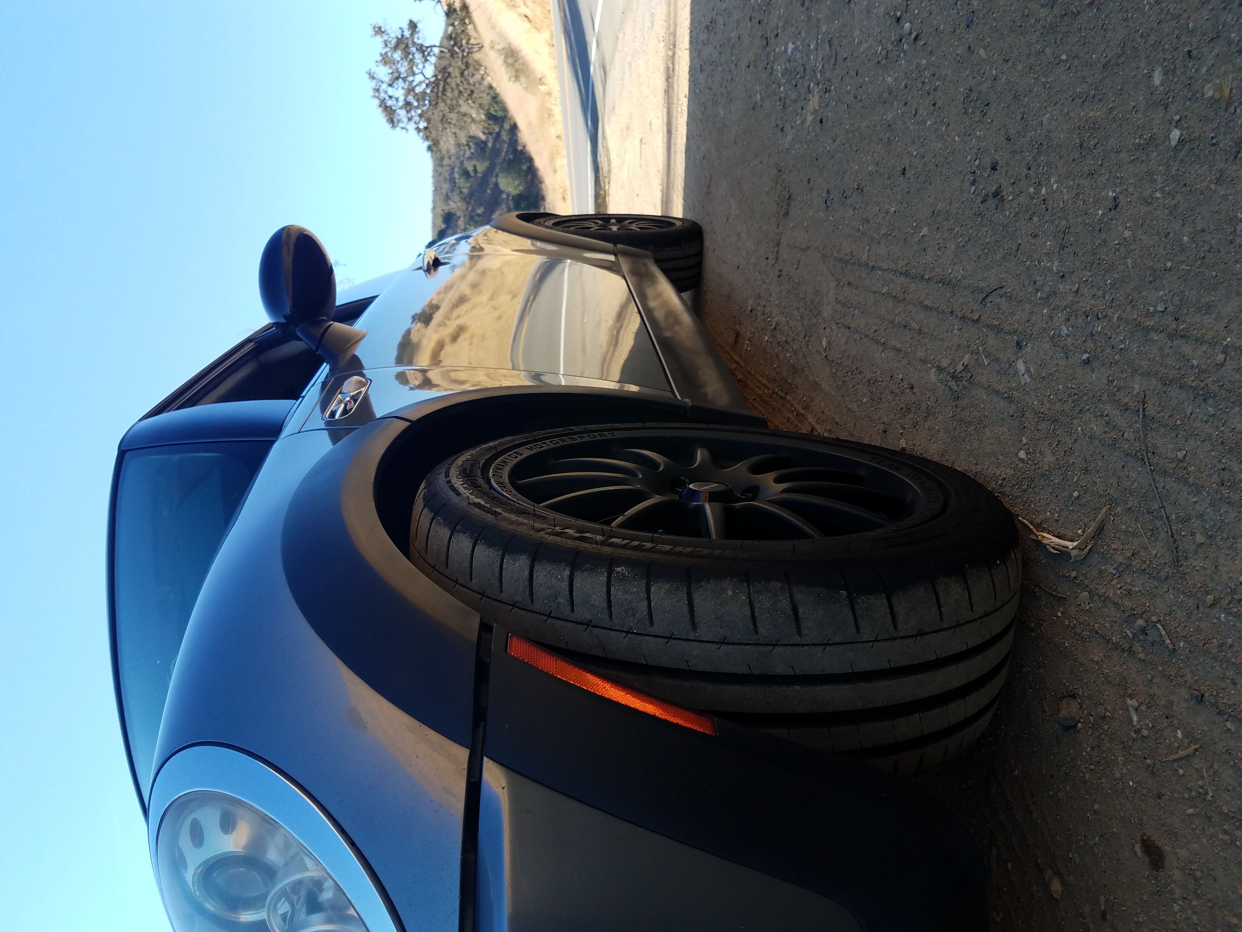

Hi everyone,
New here, and I wanted to see if I could get some feedback regarding my R53. I have an 06 S with manual 6 speed with 147K miles. I bought it 4 months ago, because I got a smoking deal from Mini of Long Beach and it was the right car for me. Black light weight Team Associated wheels, dark grey, with the leather interior. Car felt great, and pulled hard, so I forked over the 4500 for it. SIDENOTE: since then- There is RMS oil seepage, so I will eventually get that seal installed and while I'm there, have a new clutch put on.
I quickly bought a used Alta CAI system, and and MSD coil (already had jackson racing wires). I also did the one ball exhaust mod, and got rid of the Run Flats and put Michelin Pilot Supersports all around. Love the car, am happy with it all around, but I'm thinking what other mods I can do to make it quicker. Reliability is not a HUGE concern, but I also don't want it to grenade on me every other month. This car will see 5-7K miles per year maybe. With the engine getting close to 150K miles, I wouldn't mind having it opened up and serviced and maybe port- polish and cams?? I also hear a new pulley/belt for the supercharger is the way to go no?
Thanks in advanced, sorry for the long-winded post. Attached some pics of my ride.
