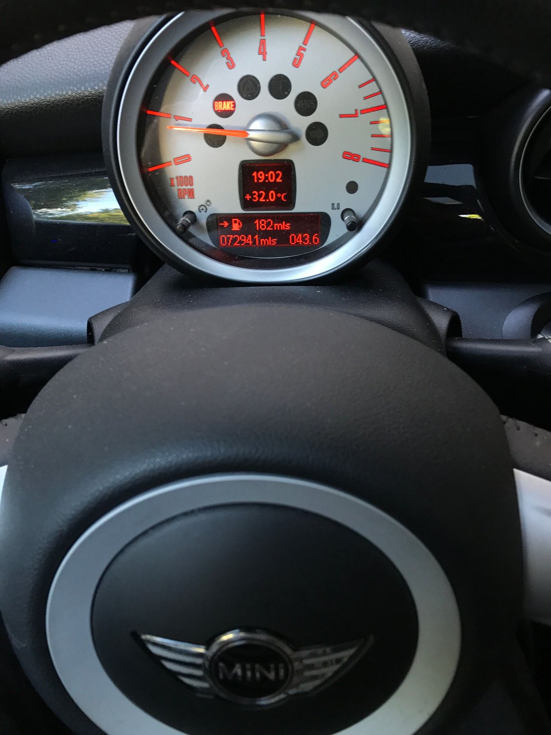

So far so good! A bit of repair work done. The JCW turbo got rebuilt and upgraded with some K04 parts and polished, exhaust manifold polished, a Wagner Tuning intercooler, an Alta inlet tube, WMW turbo resonator delete, a WMW noise maker delete, a WMW turbo blanket, a new aluminum water pump, and water hose. Both intake and exhaust ports cleaned and intake manifold throttle body cleaned. She was spirited before at around 2800 rpm:s and up. Now perhaps a bit earlier and seems to have a second wind after 5000 rpm:s. The HP gauge indicates we went over 200HP at some point. Got to highway speed pretty quick.
