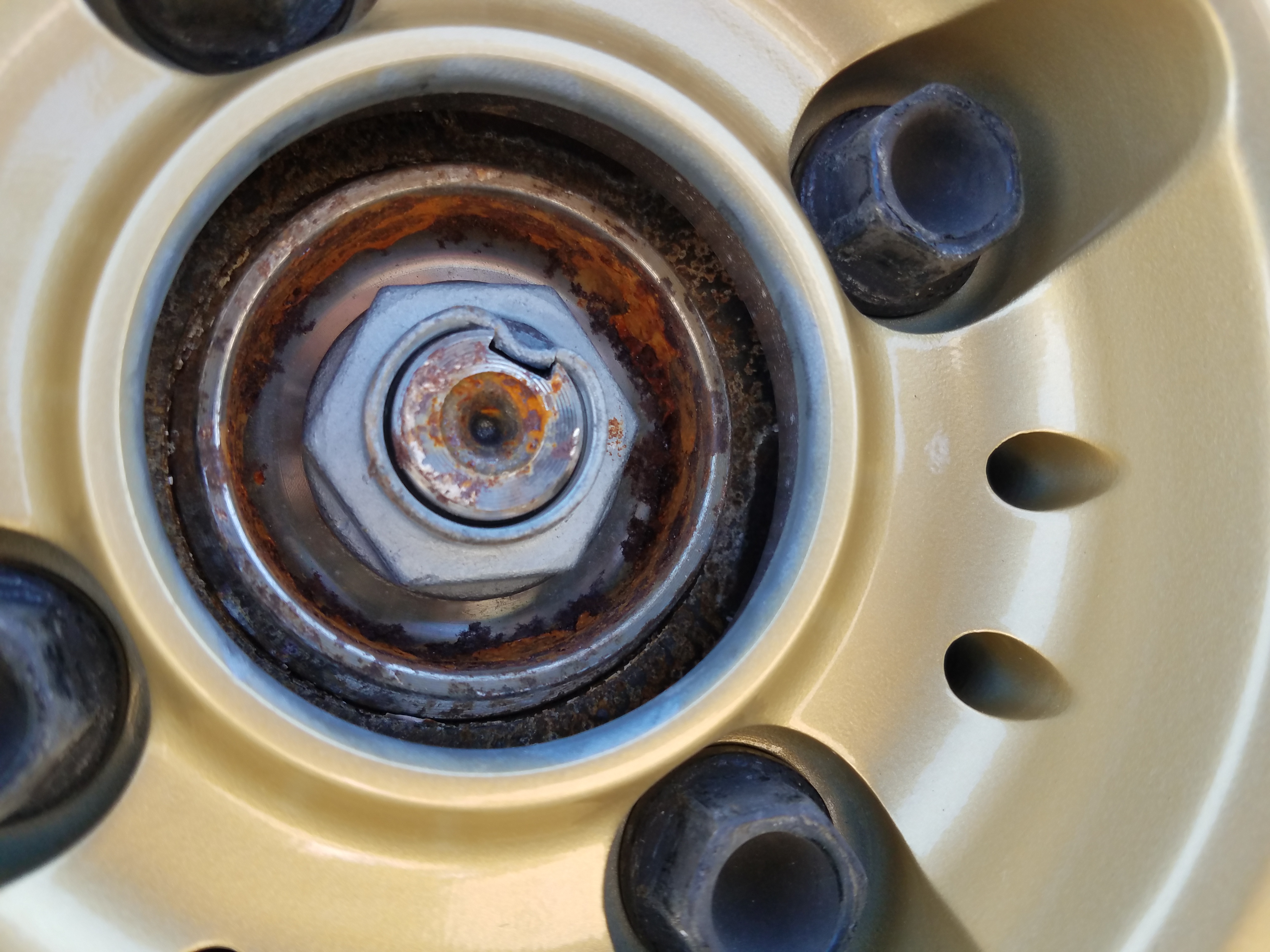

Well decided to dry fit the wheels before going to get the tires mounted on them. I'm going to need wheel spacers I Think? Also is it common for the center bore of the wheel to be bigger than the hub on the car?

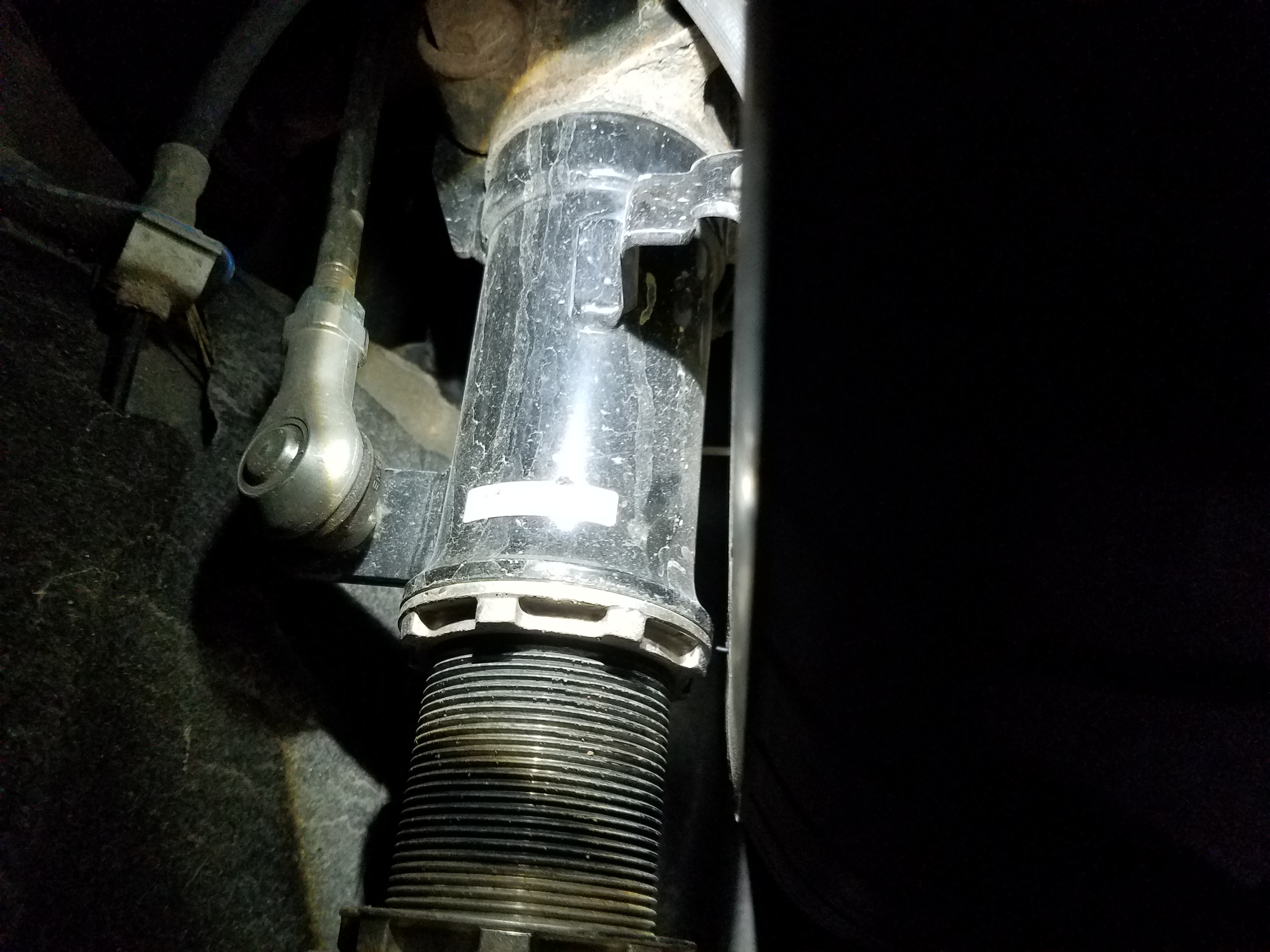

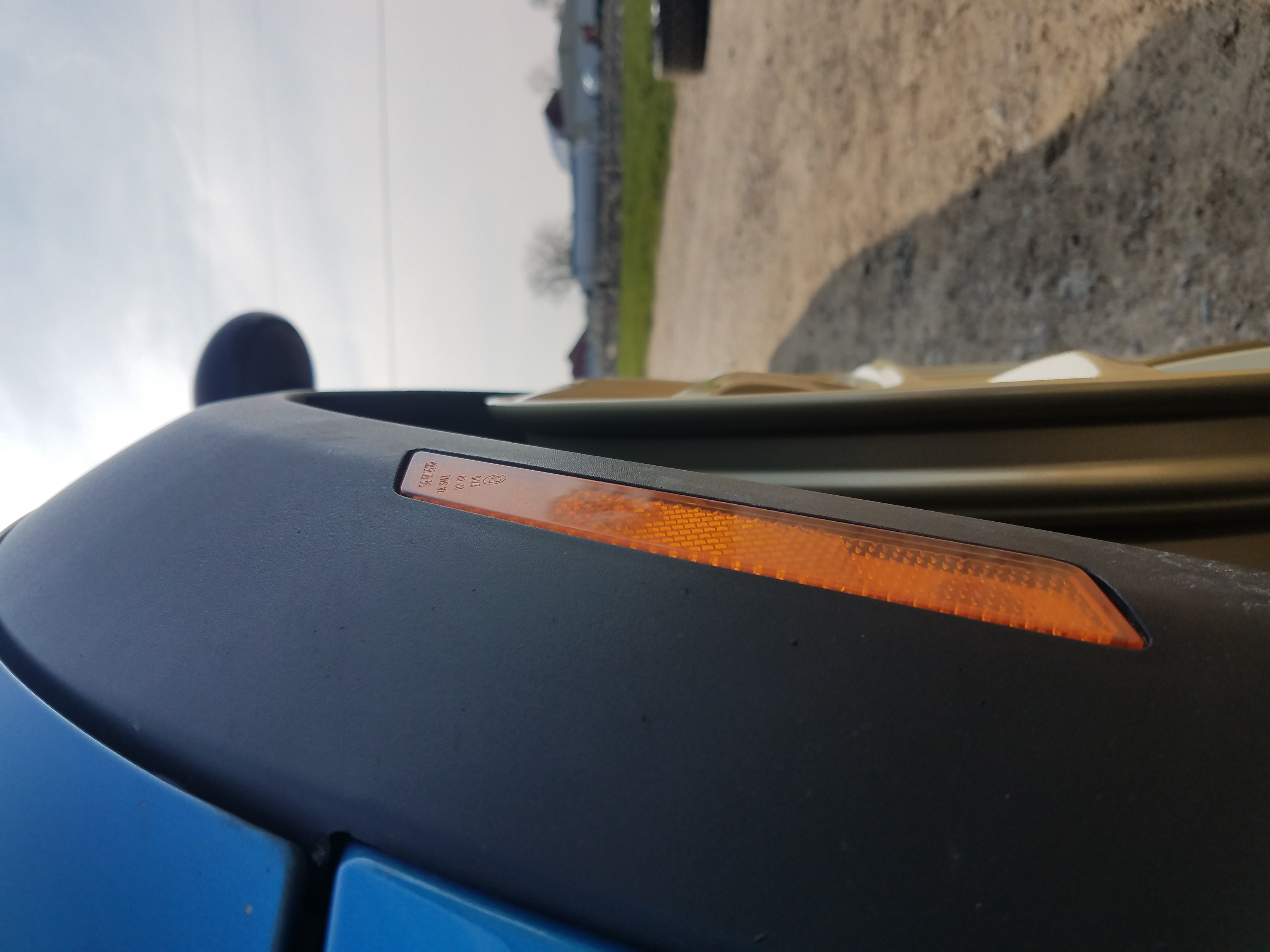

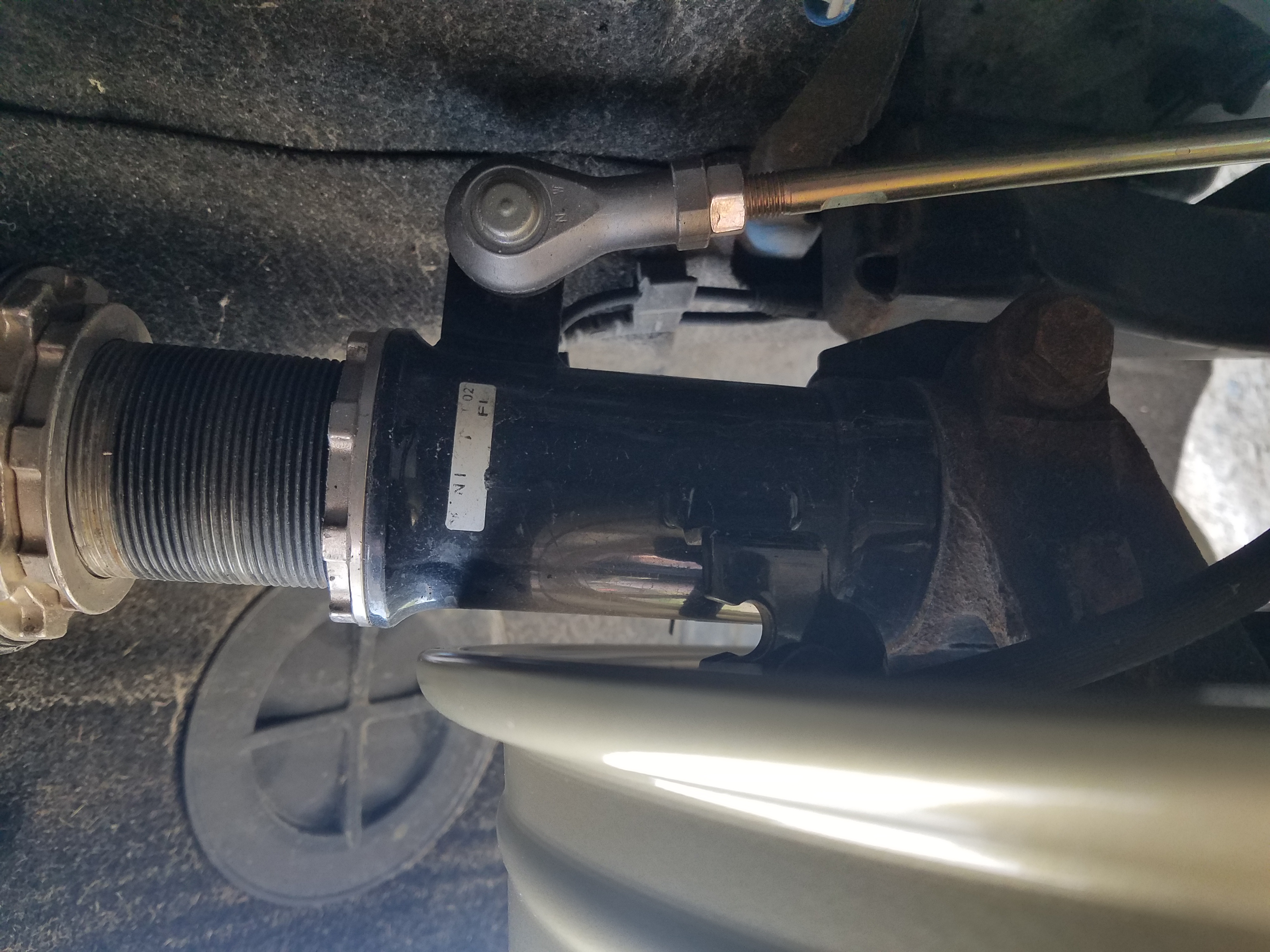

What size wheel spacers do you guys Think I will need? I not really looking for the stanced look. But I have a feeling if I space it it'll stick to far out pass the wheel well.
Attached Thumbnails Wheel color?!-20170414_172258.jpg   Wheel color?!-20170414_172246.jpg   Wheel color?!-20170414_172244.jpg   Wheel color?!-20170414_172300.jpg
Old Apr 14, 2017 | 02:41 PM
  #30
Posts: 36,758
Likes: 2,548
I think is you go 8-5mm you should be fine. 15mm might be poking. Front look like they are almost flush.

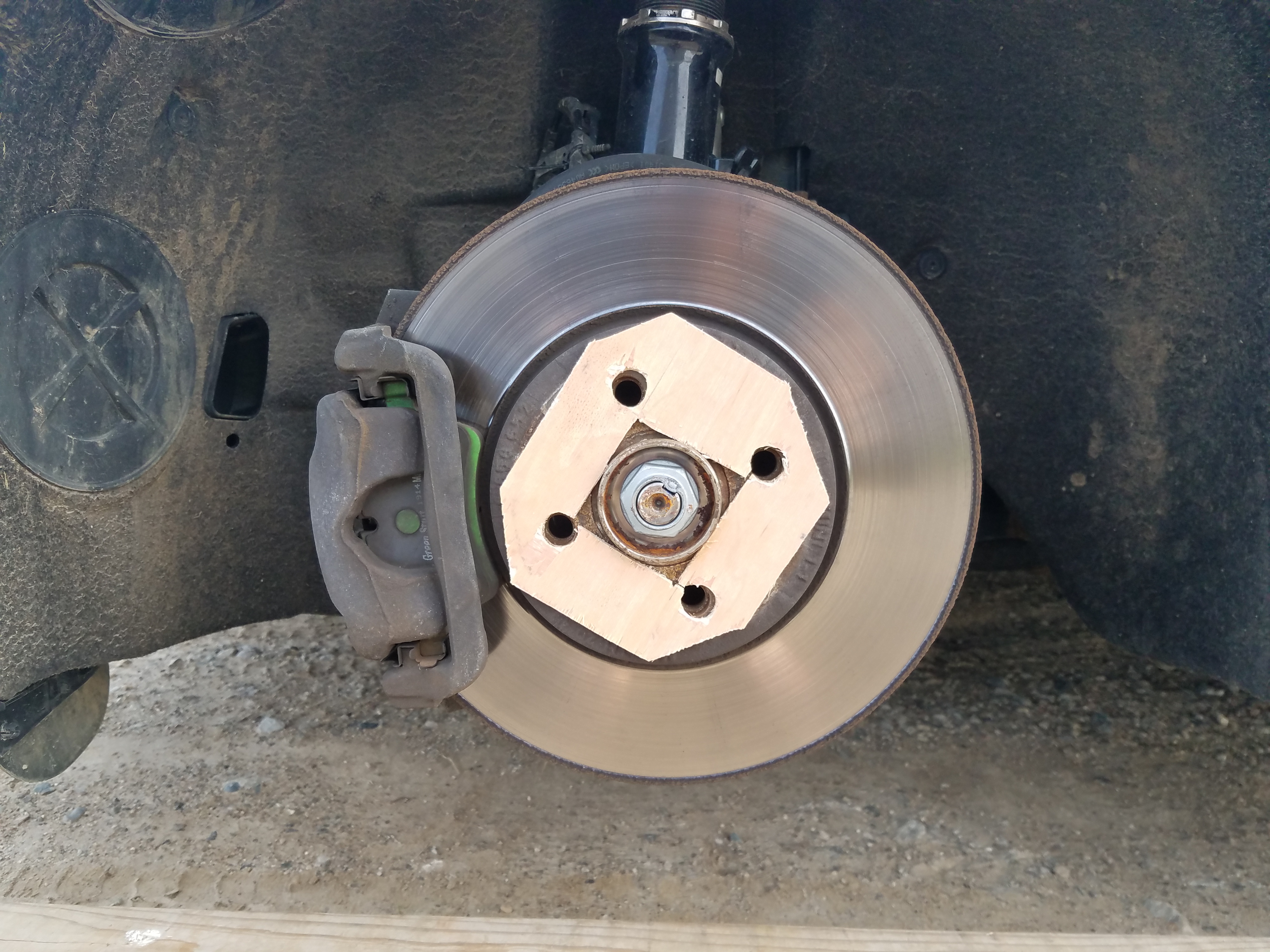

Well I found a piece of wood that was exactly 5mm thick and I made a makeshift spacer to see if that's the size I will need. It's still close but not sure if 5mm will be enough.

Well got the tires mounted to the wheels today. First off I was say I LOVE the gold! I put my diy 5mm spacer on to see if it would be enough and it clears, nothing hits or rubs. But does it seem to close still? I think ordering 5mm will be ok but want to see what you guys Think.

also keep an eye on the cables for abs sensors (both) and brake wear sensor. had my wheels on and off enough that i noticed they had been getting rubbed. where they come out from behind the fender liner there is a square hanger they sit in- i pulled the cable out, flipped it upside down and put the cable back in the same hanger
