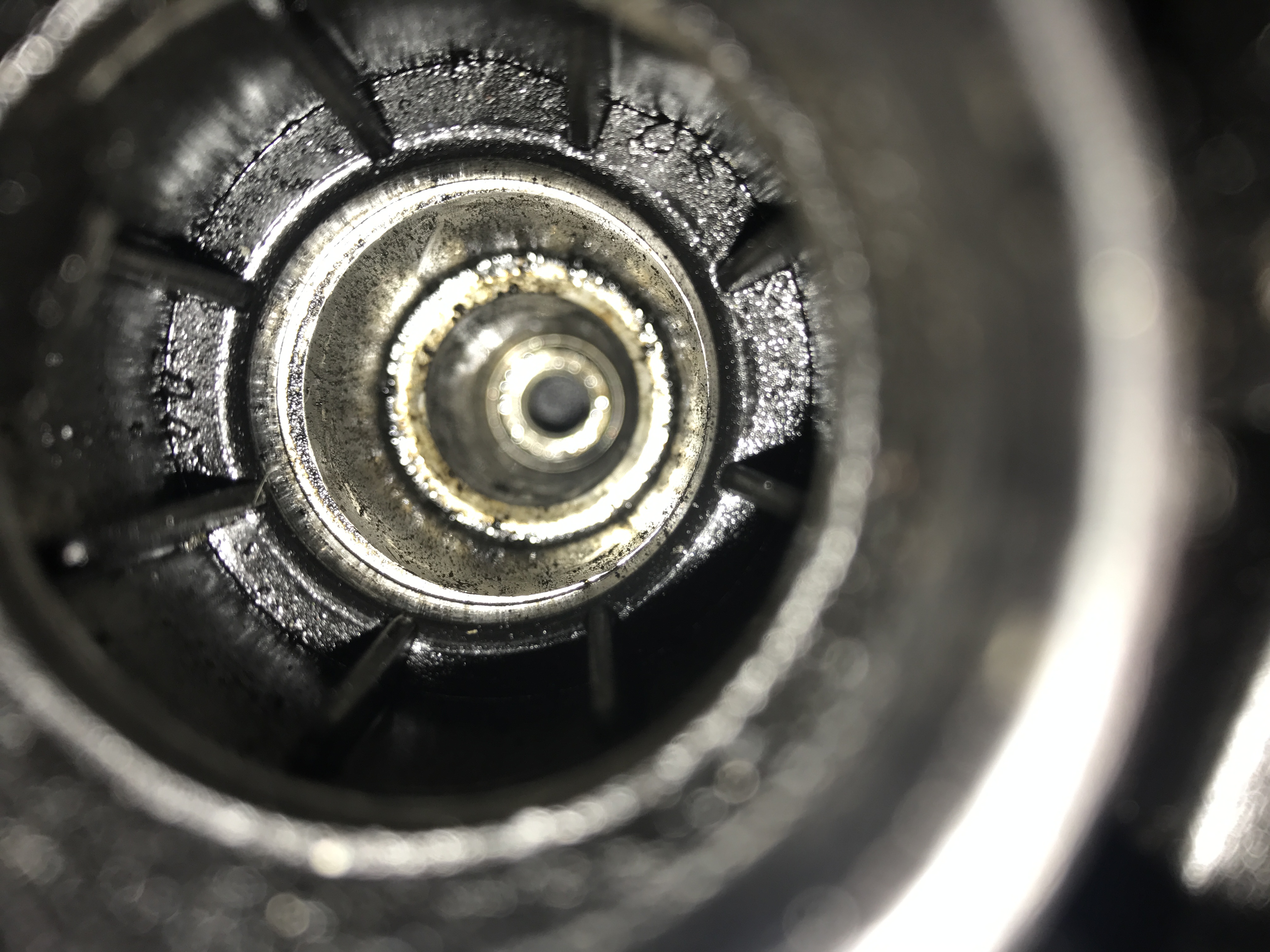

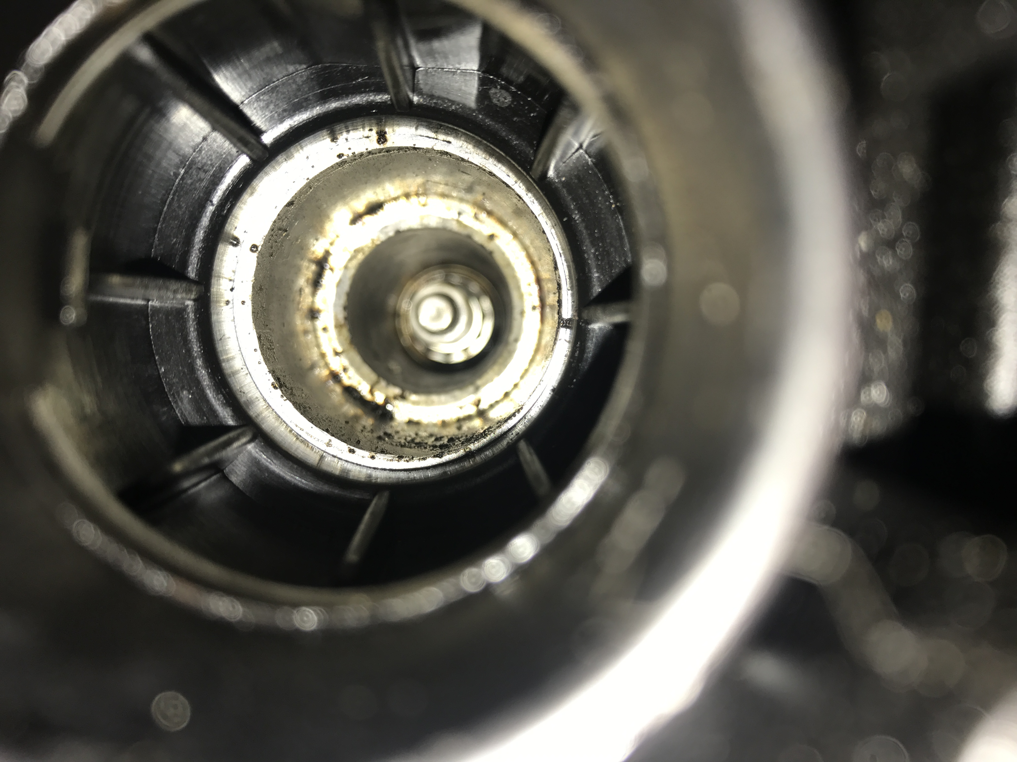

Where to begin... Recently I have replaced the clutch, flywheel, rear main seal, clutch fork, and input shaft seal. All went well and now I'm having oil consumption problems. ( note: Also I had done an oil change while I had the car torn apart). since then I have topped the mini off very frequently and it's getting to the point where within 100-200 miles it's at the minimum level. I thought that maybe the rear main seal was leaking but I pulled the slave cylinder off and all was dry on the inside. Next, I decided that I'll pull the spark plugs to look for any oil leakage. There I found some. I'll post pictures below. As you can see there was oil inside the spark plug hole and I'm thinking maybe a bad valve cover? Could there be this much leakage through the valve cover? I have replaced the oil filter gasket so I know that's not it. No visible leaks.

to check for rings, do a dry compression and then a wet compression and see the difference. The leak from the valve cover isnt that significant, but you can replace the gasket to eliminate that. did you check the PCV?

Well oil can only go to a handful of places. If it is not blowing blue smoke, it's not really burning more than it should be through the thirsty PCV system + CEL would be on and if it's not leaking on your garage floor then maybe look for other variables that may have changed...
If after 150 miles you are losing a quart of oil, it should be pretty obvious as to where it is going. That's a serious leak or burn.
Fill it to the top, leave it sit for a day or two, if it's low, it's definitely leaking somewhere.
The only other thing I can think of would be checking the oil level on an incline which would produce a bad reading, or simply not reading the dipstick correctly, but I doubt that is it since you checked your oil regularly before.

So with bad pistons/rings you will notice a lot of oil burn happening. It would set off the check engine light for increased emissions as well as you would be able to see a lot of blue smoke from the exhaust.

If you have a cylinder varying between 30 and 100 PSI on test, that cylinder has a problem. I'd suggest having someone pull the plug and scope it. Might be a sticking valve as well, providing intermittent valve seat seal.
Might be a sticking piston ring or something similar, in which case you could try old remedies like soaking the cylinder overnight by pouring in a few spoons of penetrating oil, then turning it over to expel the oil, starting it up, changing the oil, and see if you freed up the ring.
But chances are that you won't hurt it by driving it, as long as you keep feeding it oil. Look for blue smoke - if you see that, the engine is burning it.
