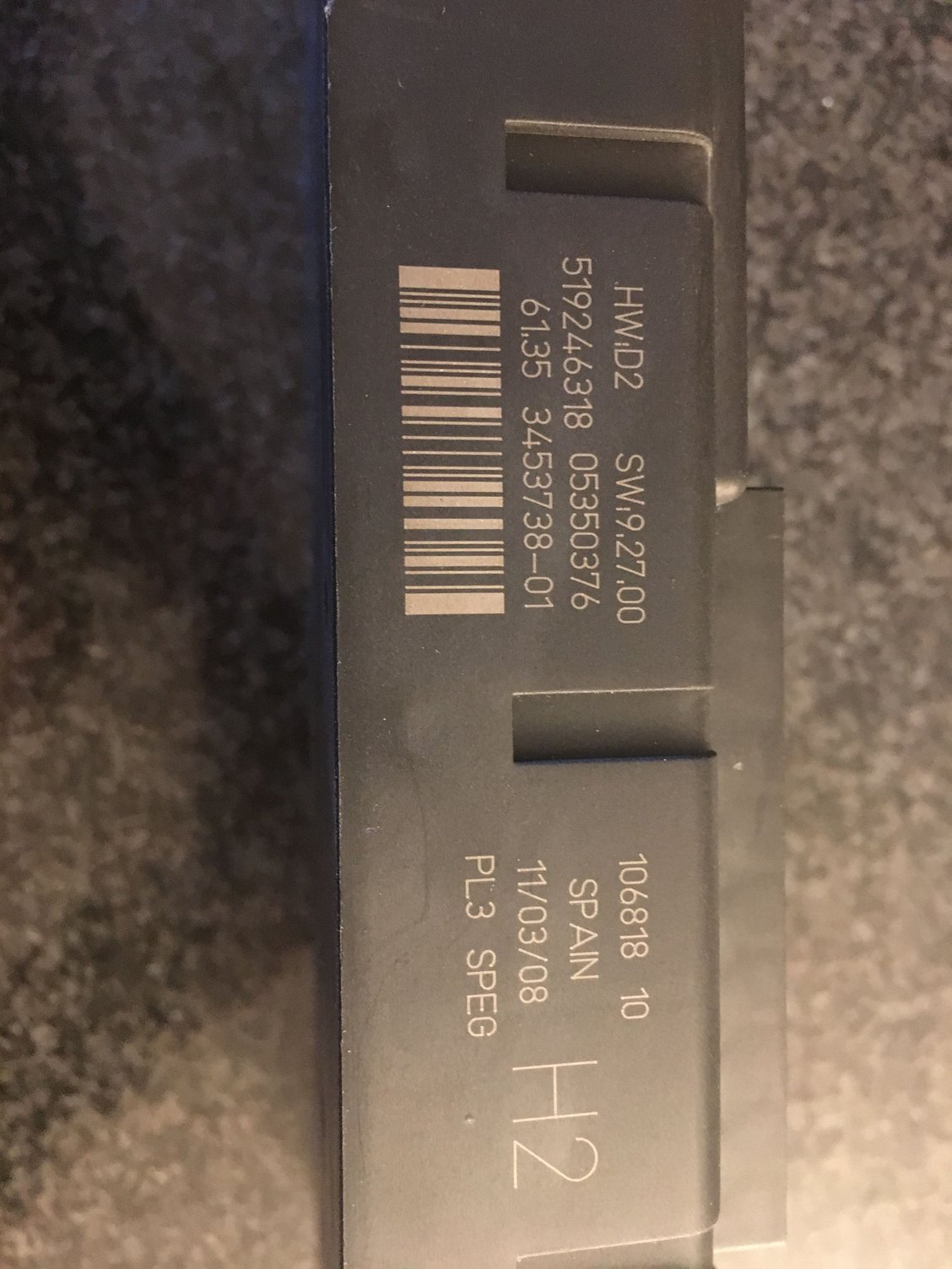

I've been gone for several days because of a death in the family; now that I'm back I need to find another one of these. Andy suspects the gateway failed when the module died.
It's covered in numbers. Any helpful hints on how to decipher which numbers I need from a part, rather than asking you guys every time? Seems like my husband and I haven't been home simultaneously for weeks and are just leaving parts out for the other.

Sorry for your loss....This is the part number for the fuse box. The gate way is the CAS module, no?
Thanks. As a general rule of thumb, am I looking for seven digits followed by a dash and two more?
Andy called it a junction box or gateway, and said it might be why a code reader can't communicate with the new module; it worked when he tested it there. He suggested finding a used one and seeing what happens; he likened the situation to a phone that works fine (the new module) but if the line is down (the junction box), calls don't come through.
It came out of the passenger floorboard side panel.

you are correct about the general rule. there is also realoem.com that you need to book mark. you can use it to verify the part numbers.
