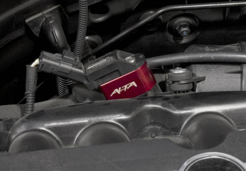

an Adapter at boost port
as far as I know is the boos sensor and it will read as such...please someone correct me if I'm wrong...

Originally Posted by isamin
where do you connect the 30/20 gauge and will it read just vacuum or just boost?
ISAMIN
There is a couple of different options for quick fit boost taps, but my favorite is the NM Boost Tap (or equivalent). Once tapped it will read manifold pressure +/- all from the same port.
With one of the quick fit ports the hardest part of the whole job is successfully routing the teflon tubing and not kinking it.
