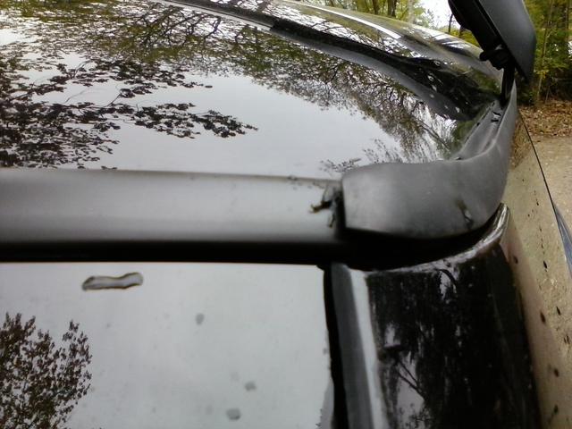

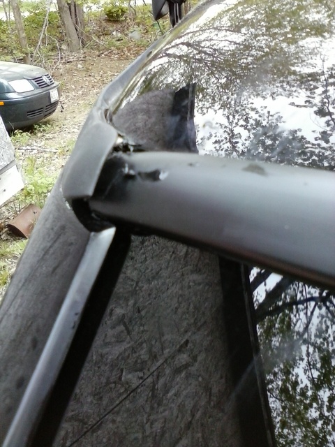

Looks like you have a roof rack attached to those rails. That may be another issue that's not helping this situation.

They are factory racks and they were on prior to the windshield replacement and the trim used to look normal so I don't think it's the racks

Just posting an update on how Safelite handled the repair....they sent a tech over to look at the car...he saw the moldings were damaged so Safelite ordered new molding for both sides and a setup an appointment when they came in. Last week they came back by my work and installed the new moldings and everything looks great now.
If anyone is wanting to remove the molding on a second gen Mini it appears the easiest way is to remove the torx screws that can be accessed when you open the door...pull out the pressure clips holding the molding over the rear glass and slide the molding forward....it will pop right out of the clip and the entire part is removed without damage to the slip or molding.

I had my windshield replaced today, I finally got out of work and got to look at it....it wasn't like this before but I'm not sure that when the original windshield is replaced that it ever looks quite right again.
Does this windshield trim look normal on the top corners for a replacement?
Attachment 143348
Attachment 143349
