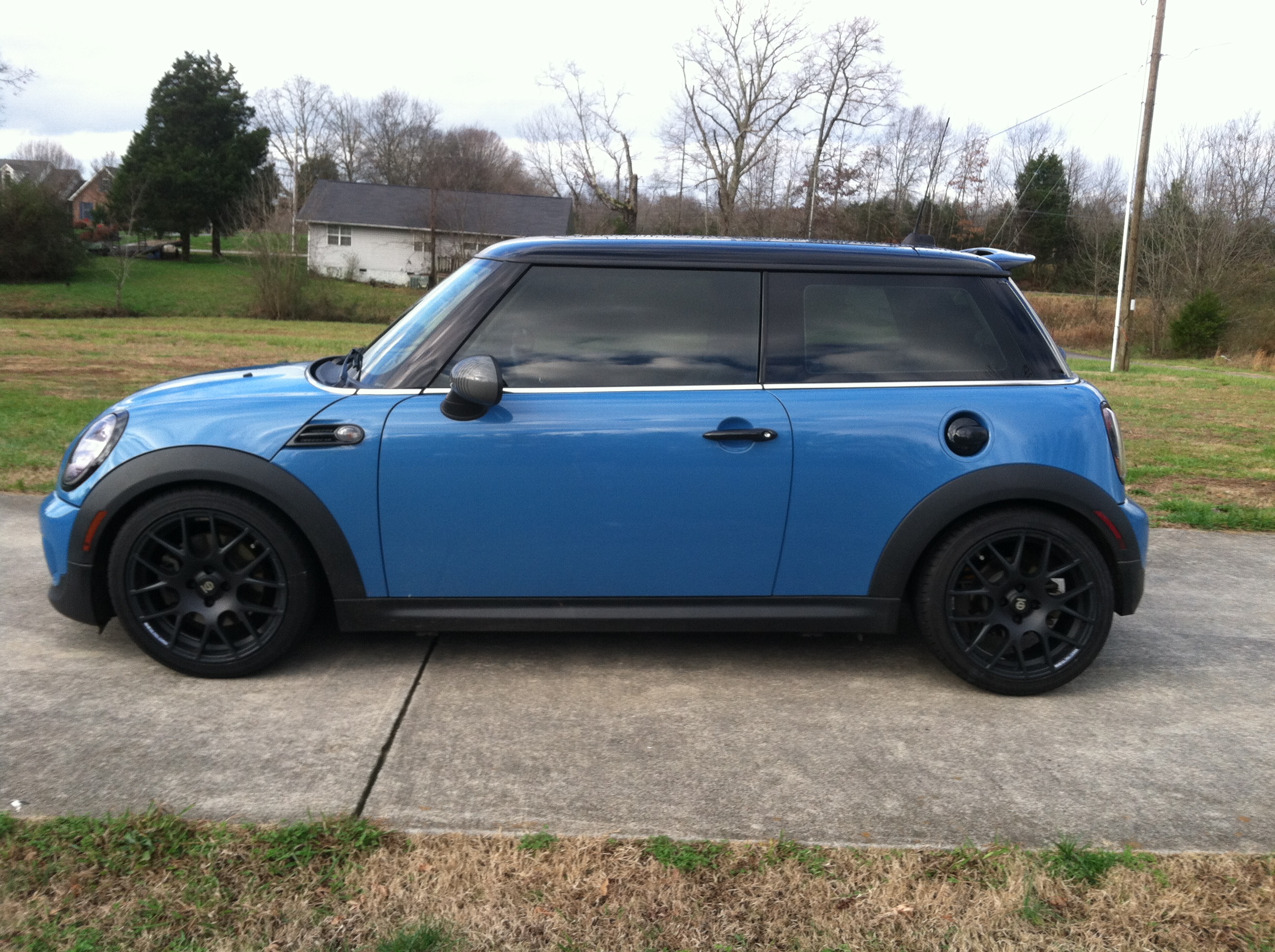

I've attached a pic of the car for reference. Just one week after the install.
This isn't a perfect pic angle wise, but its all I have on my phone.
It actually doesn't look that different in this photo but certain angles when its in parking lot makes the rear look higher.
