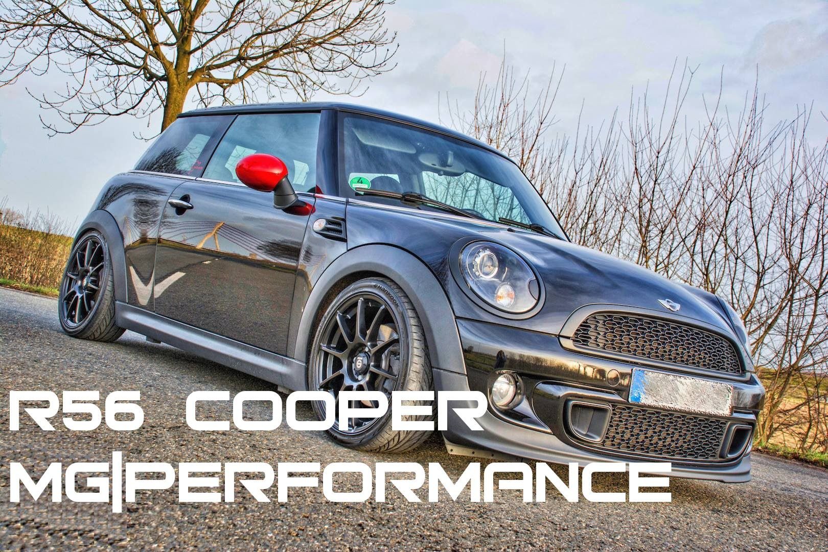

Those wheels are a bit wide. And if you want to do the flush look all the way around I'd say at least 17s.
These are 17s with a drop and a 205/40 tire.
