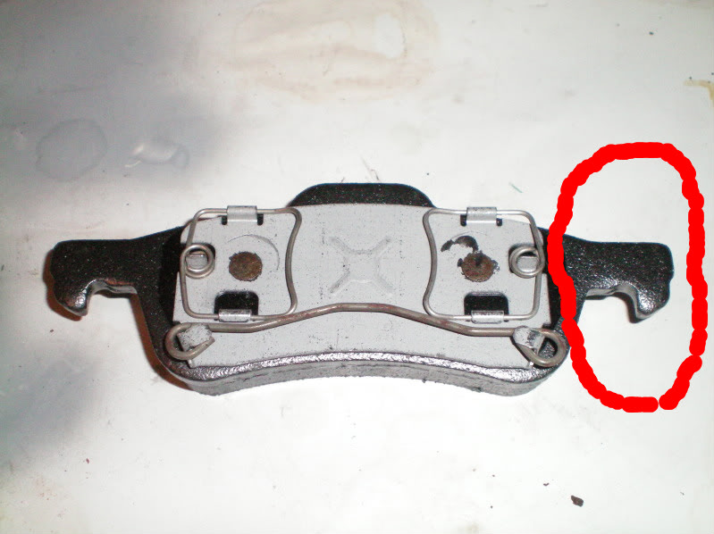

GEN1 pads have clips that are attached to the pad backing plate and are not 'optional' or removable
{gen1 rear} disregard circles

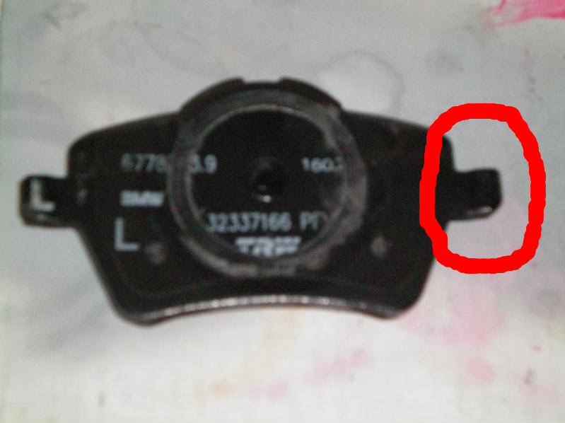

GEN2 pads have no such clips
{GEN2}
