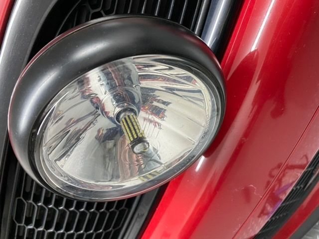

Old Sep 24, 2020 | 08:20 AM
  #34
David.R53's Avatar
David.R53
Joined: Jul 2014
Posts: 735
Likes: 24
From: Maryland
Cool! I'm happy with mine, too. Here's a before and after. A bit embarrassed I haven't changed my headlights to a whiter/bluer bulb, so really have to do that now... The more bluish bulbs are from Amazon - Labworks brand - $12 a pair - "
2x H3 30-SMD 4014 LED Bulbs XENON 6000K White 12V Car Fog Light Lamp". Supposedly these are 550 Lumens, which is probably half of what the halogens made. I will switch the other side out with another brand that claims to be brighter.
After - cleaned the inside and LED bulb
Before - haze on the inside and original halogen bulb
showing color temp of the LED compared to Halogen.
