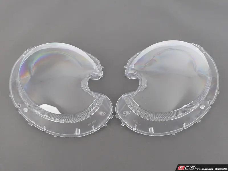

We have the xenon ones here: https://www.ecstuning.com/b-bremmen-...02347698lens~/ 275 degrees for 10-15 minutes for removal, and 275 degrees for 5 minutes to rebake after the seal and lens are connected. Then let cool.
ES#3619826 for butyl tape.
We dont have the NON Xenon r56.
