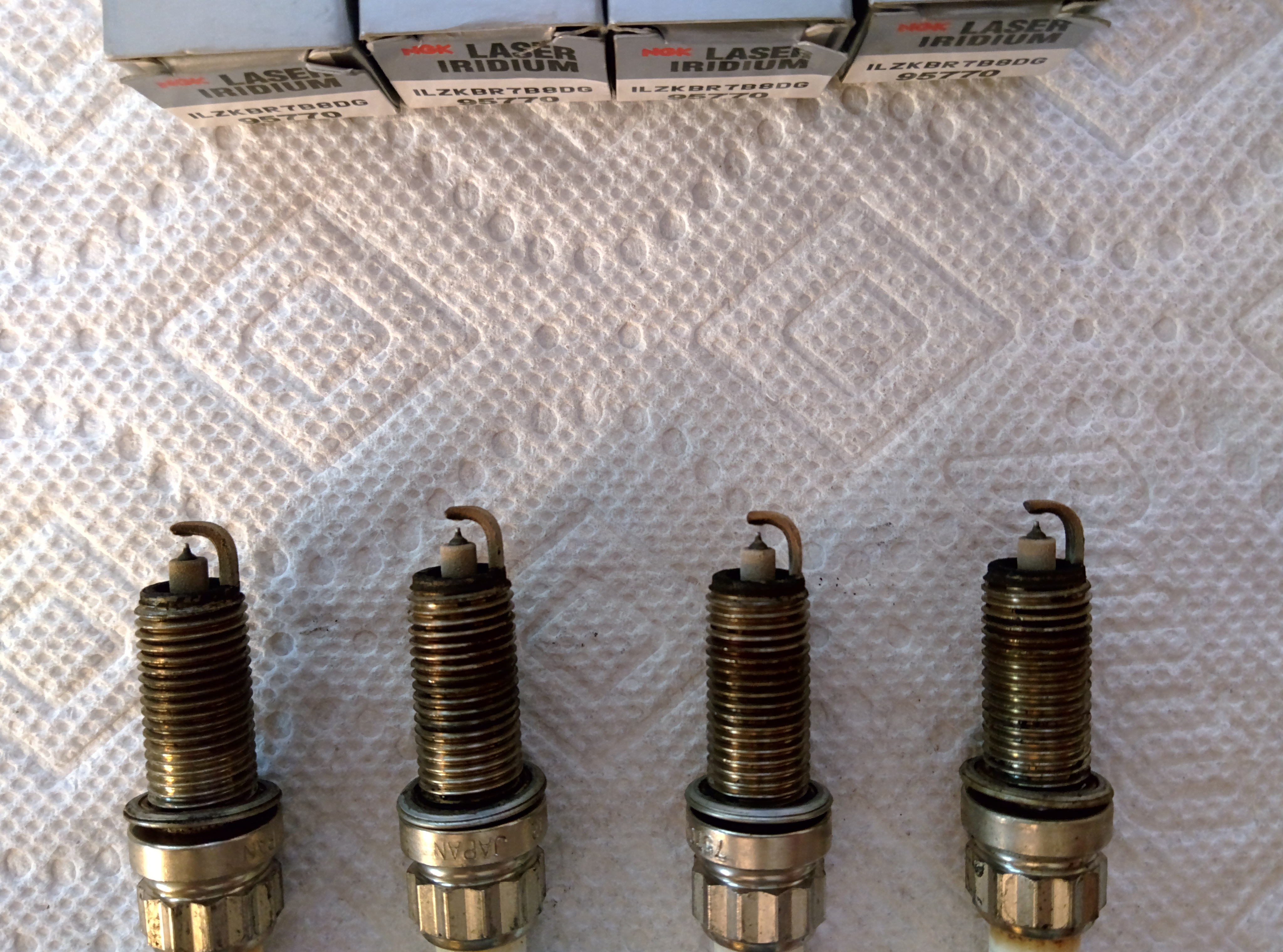

Changed the spark plugs
Simple job, didn't have any issues.
Car is a clubbie S with 63k on it. I've had it since 48k and hadn't had the plugs out yet.
Wasn't sure if it was running the originals or not. Replaced them with NGK 95770s, which I understand are a step colder than stock.
The plugs I took out were all gapped around .029-.030.
I've seen a lot of threads in plugs, I cannot stress this enough, always check the gap of your new plugs. Mine were all over the place. Two were around .015 or so and the others were close to .028.
I gapped the new ones at .032. Car is stock except for an Alta BOV spring and a K&N open filter.
Fired up with no issues. Haven't test driven yet. (Kids were napping. :-) )
Here's the old ones. Thoughts on how they look? #1 (far left) seems a touch darker than the others.

With 63k on them, look normal to me..

ah they are fine everything looks good should be a light tan but they look dry no oil residue. but either way good precaution at 63 k
contrary to popular belief plugs are maintence not replace when you have a misfire

Yeah, I was happy they weren't wet or anything.
Went for a test drive and car seems peppier and smoother through the RPMs.

The ground electrodes on those plugs are coated with platinum. When you bend the electrode to adjust the gap, you crack the coating and the platinum burns off.

Then why are they sold and marketed as gapable plugs? I didn't touch the very frail looking electrode.

Those look normal to me. You must have had the special thin walled 12 point 14mm socket to take them out. Very handy.
