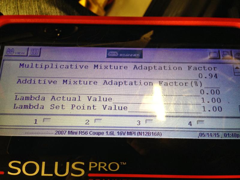

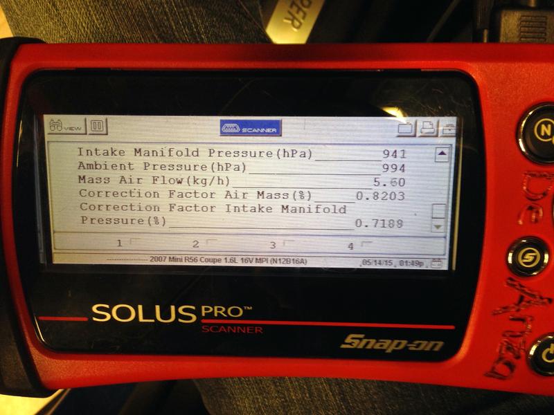

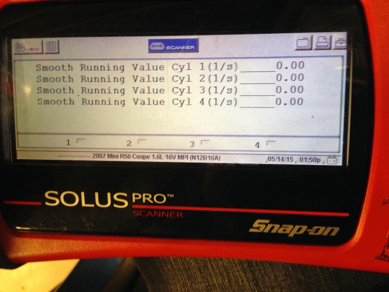

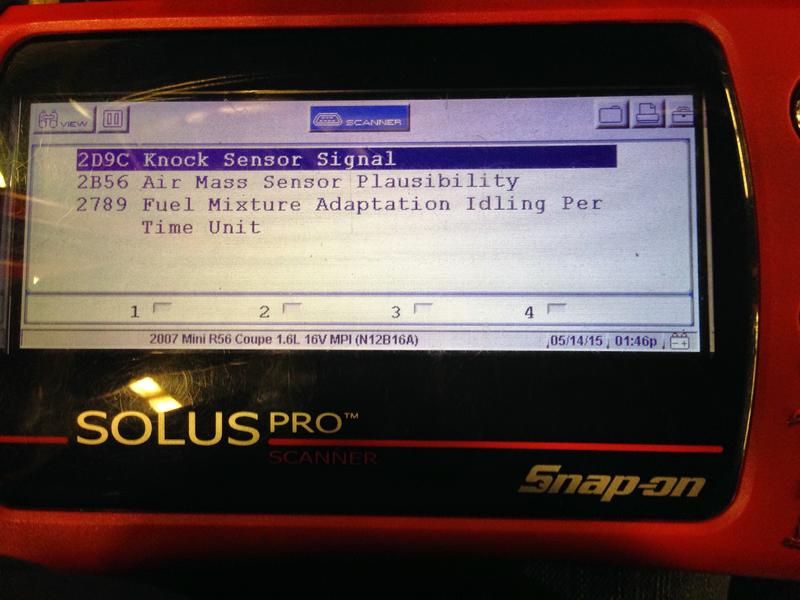

Ok, I finally was able to hook up a scan tool to the car. I took pictures of the live results (attached). I did not find the freeze frames in this tool in the time I had. However, after resetting the codes, the engine light turned on again and I later scanned it with an elm327 adapter (which showed a P115C, Air Mass too low code). Below is the freeze frame info I was finally able to pull from the elm327 adapter.
Though the long term fuel trim on the freeze frame below is slightly negative, it looks like it's within acceptable range (given a basic google search). The air mass flow rate does seem a bit low, but I haven't found any good references on where that number should be around for a given speed. I suppose it can be roughly calculated given the speed of the car, but I think the air flow pressure in the engine would alter this calculation a bit.
What do you guys think would be a good next step? I could try the MAF cleaner, but not sure if the snapshots indicate I should focus elsewhere.
