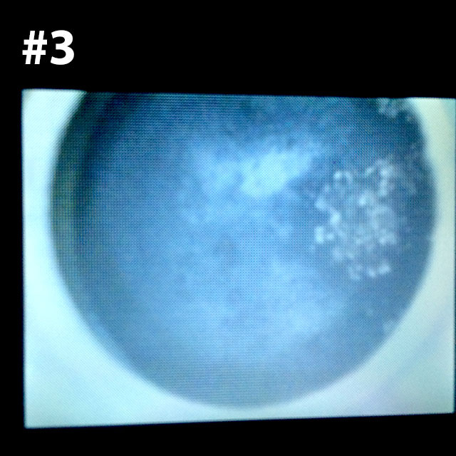

I tried to get a look and the gunk in the cylinders of #2 & #3 with a scope. They don't look that bad. #2 is definitely worse. I did just have a walnut blast done.

Your going to either need to rebuild or buy a new engine, I would take this time to do your own build with forged parts.
Number #3 and #4 are the only healthy cylinders you have, the #1 probably have the most carbon build-up around the rings and piston tops exaggerating the reading of 180 psi. My #1, #2, and #3 all read 165 psi and #4 180 psi, the latter has the most carbon on piston tops exaggerating my psi rating. It's well known that some N14's cylinders go bad prematurely do to flaw in machining of the cylinder walls, you can thank Mini USA for that. How long you had your tune?
