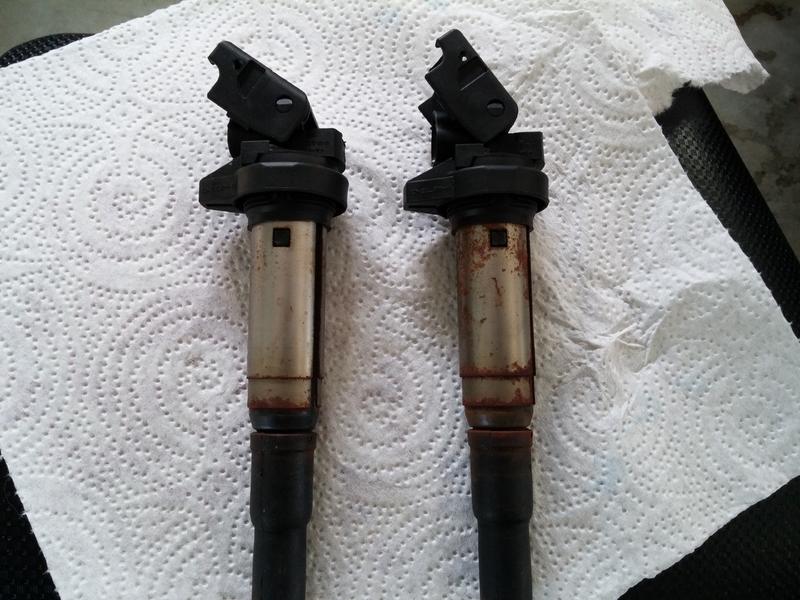

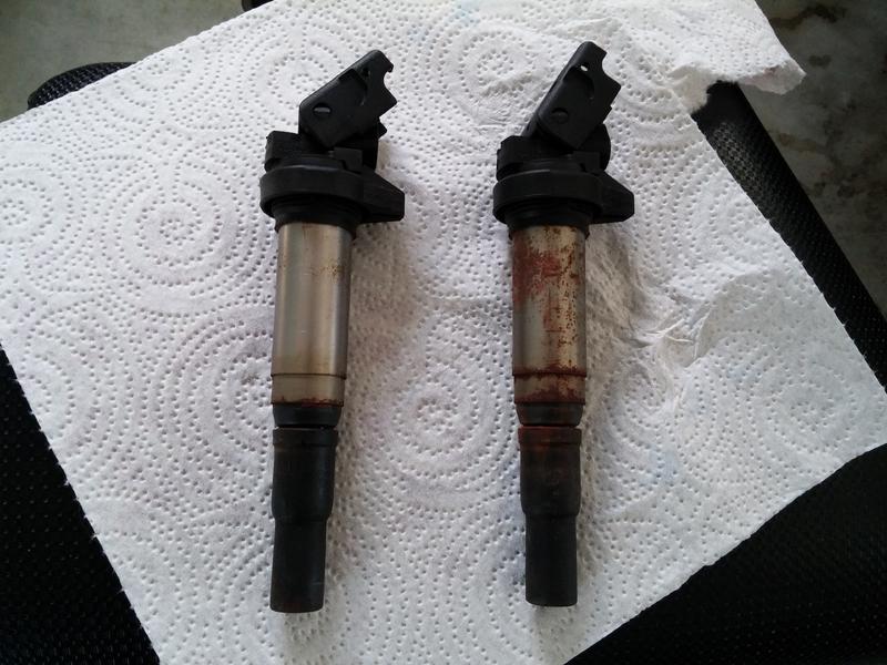

heres two photos of coils from cylinders 3 and 4:
Attached Thumbnails HPFP issue?-2015-03-15-16.36.55.jpg   HPFP issue?-2015-03-15-16.37.30.jpg

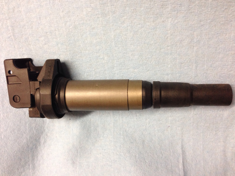

Honestly I'd replace all the coils. Start with a clean slate as it were. Here's a shot of the Mini ones I replaced at 64k miles with Ignition Projects coils. Notice the name on the side. It seems Delphi is the OEM for Mini.
Attachment 107513
interesting, so that is the original coil. I was looking on rock auto, and they sell a pack of 4 coils for $22
https://www.rockauto.com/catalog/mor...nid=372&jpid=1
i have no idea what I'm looking at in the picture. can the coil somehow be taken apart and bad part be replaced with whats in the picture?
