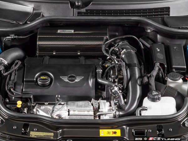

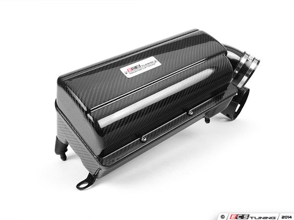

We do have the ECS CF intake that fits all N14 and N18 engines.
https://www.northamericanmotoring.co...er-intake.html
