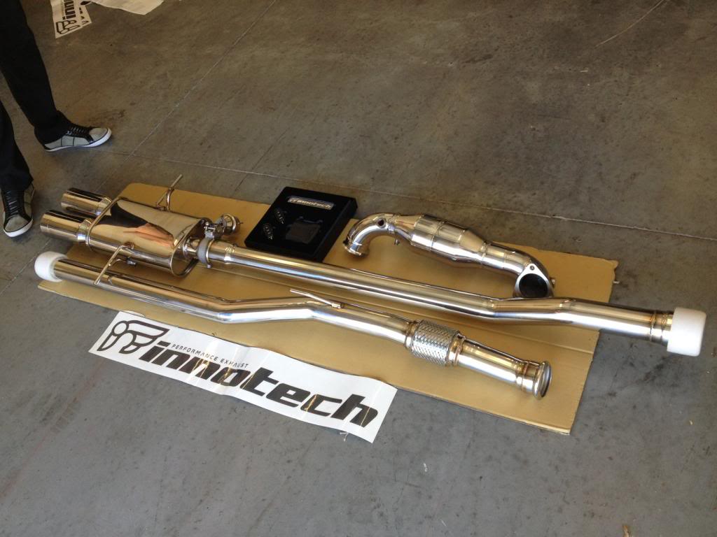

Originally Posted by cerenkov
What's limiting the boost in closed mode?
There is a valve in the exhaust right before the muffler, see photo below, that the vacuum line connects. When it is closed, the flow of the exhaust is greatly reduced to reduce the noise level. This reduced flow is what causes the reduced boost pressures (at least this is my understanding and someone can correct me if I am wrong).

Originally Posted by igzekyativ
...One things to note, is that right now I am running the stock DP and stock exhaust but I did not remove the vacuum lines that I ran for the iPE. I just plugged the end that would have connected to the valve in the exhaust. So I really don't think it is the vacuum line because the car is running just fine right now.
The only thing that really makes sense is that something is defective in the valve. By disconnecting and plugging the vacuum line you are eliminating this defect, and you see this because the engine performs fine.
I think that you will find your issue in the exhaust valve.
Maybe iPE will replace it. Unless someone stuck a banana in the tailpipe, a cat back system should not cause issues.
I am not convinced its the valve since I haven't tested the Evolve DP with the iPE yet. The valve opens and closes no problem because I can clearly hear the tone difference and how much boost is made.
If I am slow on the throttle I can build up to 20 psi without compressor surge. Its only when I quickly put the pedal to the flow that the surge occurs. (when I run the setups from post #13, numbers 2 and 5)
I agree that a catback should not cause problems, so this is very frustrating, especially since this system was so damn expensive and ra2fanatic has the full system without issues.
I just flashed Stage 2 and I am going to run around today on the stock DP and stock exhaust to test out this setup, then later tonight I will install the Evolve DP and run it with the stock exhaust and Stage 3 tune tomorrow. Then at some point next week, if there are no issues with that setup, I'll put the iPE back on, to run with the Evolve DP and Stage 3 tune, and see how it goes (I am hoping that this is the solution).

I think that iPE is passing the buck. While there might be some truth in what they say regarding the diverter valve you are experiencing the surge at WOT where the diverter valve does NOT factor in.
Surge happens when boost pressure is high but air flow is low. You're trying to cram more air than the engine can take. So installing a higher flowing cat back exhaust should definitely NOT cause surge.
You need to figure out what is causing the restriction to air flow. The only thing that changed was the iPE exhaust.
I keep going back to the exhaust valve and the vacuum lines. If for whatever reason the exhaust valve is cycling (may be due to a weird vacuum signal) this could cause a restriction and the surge. Is there a way that you can manually lock the exhaust valve open without hooking up the vacuum lines and try it like that?
Regarding the lower boost pressure with the exhaust in "quiet" mode. This itself should not cause lower boost pressure (I could see it causing surge). It seems that the vacuum lines are doing something to lower the boost pressure. It would be nice to know exactly how this exhaust works.

iPE NA got back to me today - "The surging is most likely be cause by the stock compressor recirculating valve not being able to handle the increased flow rates. It is a common problem with tuned MINIs and especially MINI's with Automatic's and or ECU tuning. I would suggest looking into replacing the recirculator valve with a higher performance unit from ALTA or Forge."
A leaking diverter valve will cause a boost leak not a boost surge. My car is an auto with the original diverter boosting to just shy of 22psi no problem.
I know that system cost a lot of mulla and I'd be pissed too if it was causing problems.
Is there an iPE dealer nearby that can take a look and rule out the exhaust causing the problem.
