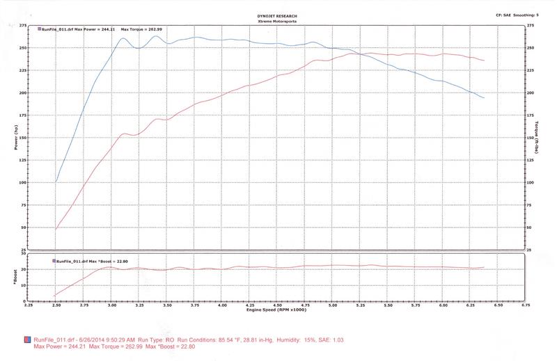

I'm assuming that you're referring to the N18 engine, what would a stage 1 Map A, B and C be on the N14 MCS PSI wise?
Stage 1 target boost pressures are the same for N14 and N18. The turbo is the same size so target pressures are the same.
Stage 2 gets a higher pressure Map C of 1.5 bar.
Again these are target pressures and it may not maintain that pressure until redline with the stock MCS turbo as it runs out of "breath" but we have tested JCW turbos and found solid boost readings all the way until redline.
We will be dyno testing some of our stage 2 MCS cars once it cools down and will log boost also so we can show the running out of "breath"
Manic tunes don't use overboost either so there is no spike in boost at all. I'll post a dyno sheet with boost logged below.

Boost logged dyno pull
See attached

So can I solve this with adding a JCW turbo (37mm to 40mm compressor) so I don't run out of breath at 4k?
I don't think the MCS turbo drops off that fast but I'll post more info once we cool down and get some good dyno runs in again.
If I recall correctly the MCS typically drops to around ~15 psi around redline per Nick. Of course there are many variables since it is a turbo car but our JCW test cars had no problem holding boost as you can see in the dyno sheet with boost logs.
We personally like the JCW turbo because it does the job well. No excessive lag and it's power has been proven time and time again. I've yet to see a full dyno sheet for a hybrid/big turbo that looks as good for a street/track car.
