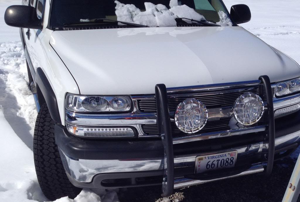

Not sure about the cosmetic thing, but I have mine adjusted to reach a little farther than my Xenons and to each side a bit. It has helped me avoid deer on more than one occasion. Same reason I installed 8" driving lights on my Suburban. On the country roads I live on it's a big advantage.
