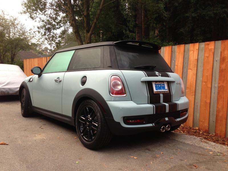

Sorry for just stating "ride quality" in my Q. I know that all of these tires will perform better than the Contis that can't come off soon enough. Why take a fine ride and put that crap on it?!?!?!
What I really meant is which size will allow the MCS to properly enjoy a spirited drive without flying off of the road?
I believe that the larger size may fill out the wheel in the MCS below...although it would be nice if someone could confirm that they have successfully installed the 205/55R-16 on the wheels of this MCS...
Attached Thumbnails Michelin Pilot Sport A/S-2012-mini-cooper-s-2.jpg

Of the three sizes 205/50-16 maximizes cornering ability due to wider tread (over 195) and lower center of gravity compared to 205/55. However, most people would not detect the difference while driving on public roads. In motorsports it would make a world of difference (where a one second advantage is huge).

Understood...I have more factors to consider than cornering...although we do have some twisties in this neck-of-the-woods...once again I've not specified much...I'll probably just go with the size that costs less....as you suggest, either one will be fine and the differences imperceptible to some/most of us.
