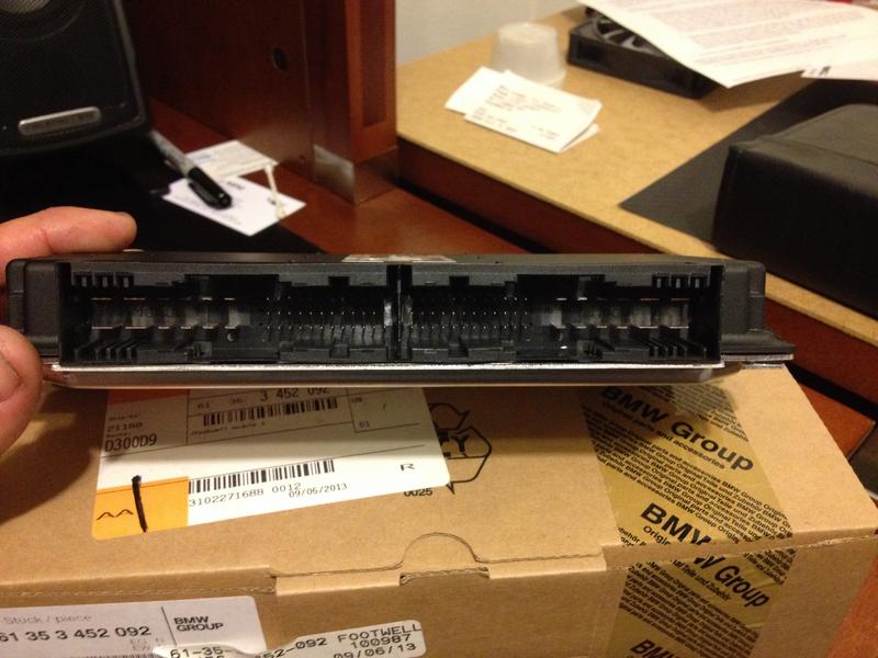

You'll never guess what happened today, both my license plate lights went out after coming home from work. I'm not kidding, dealer charged me $5.01 each. This issue seems contagious, what are the odds?
I hope they find your problem soon, electrical problems can be worse than mechanical.

For a moment I thought, "no way I'm having the same issue as you!" I was freaking out man, well until lit back up! I just had my entire footwell module replaced, here's my bad one. These are known for there reliability.
