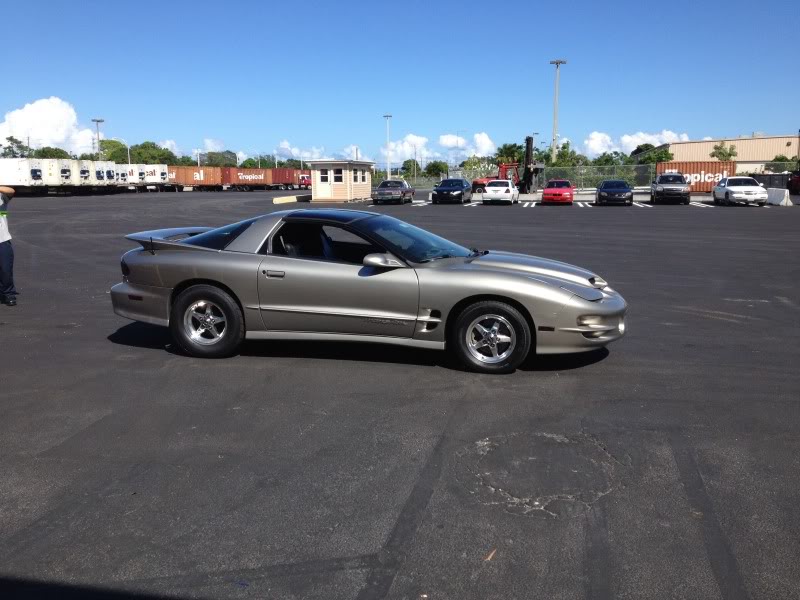

Yea those battery's crack me up. A coworker brought in his 2002 trans am last Friday to work. 400 on motor 600 with nitrous. Pops the hood and a tiny 10 pound battery in the engine. Powers an amp, gauges, and all the whistles with a 10 pound battery in this beast.
