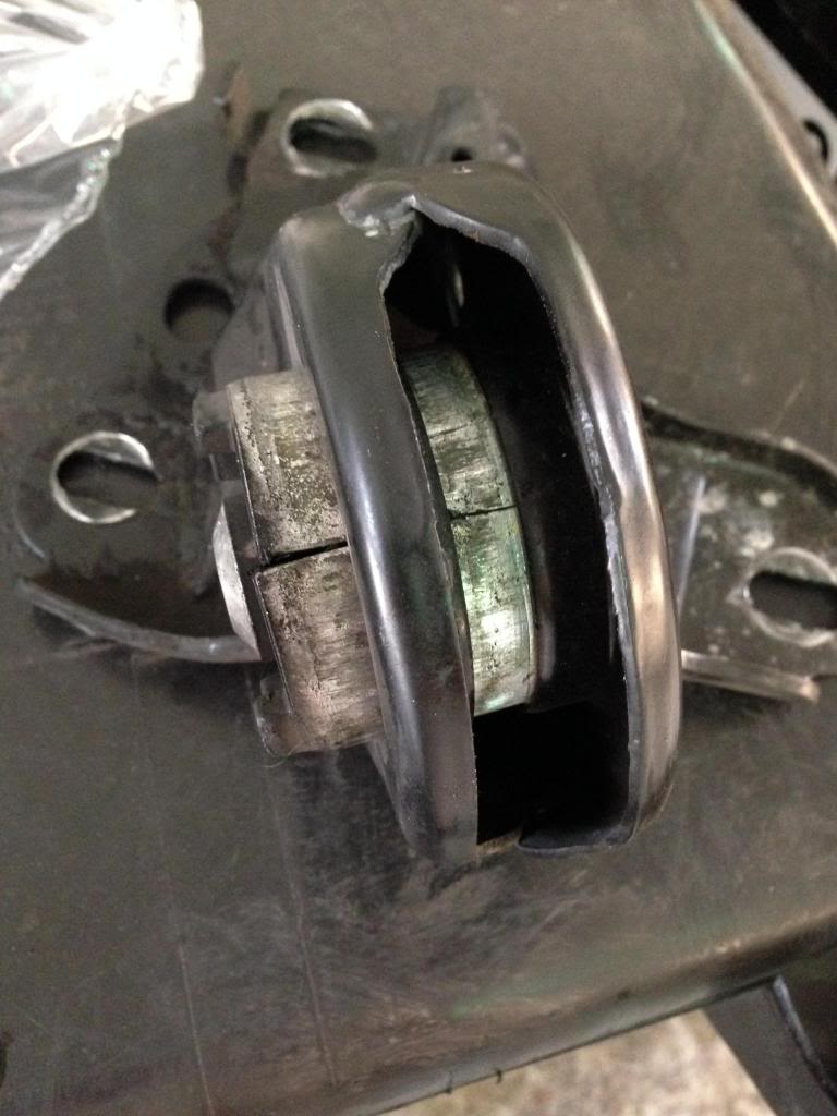

The lower control arm mounting bracket bushing I guess is what it's called (?) had been pushed out significantly. I removed the lower control arm...
It took some damage.

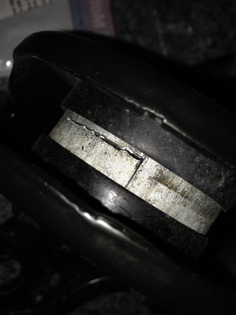

After I pushed the bushing back into the slot, I noticed something that just made everything so much better...
A nice big crack through the entire bushing. I had my parts counterpersons call the local MINI/BMW dealer to see if I could buy just the bushing. NOPE. Gotta buy the whole control arm. Greaaaaaaat. I said screw it, pushed it back to where it needed to be, and aligned the car.

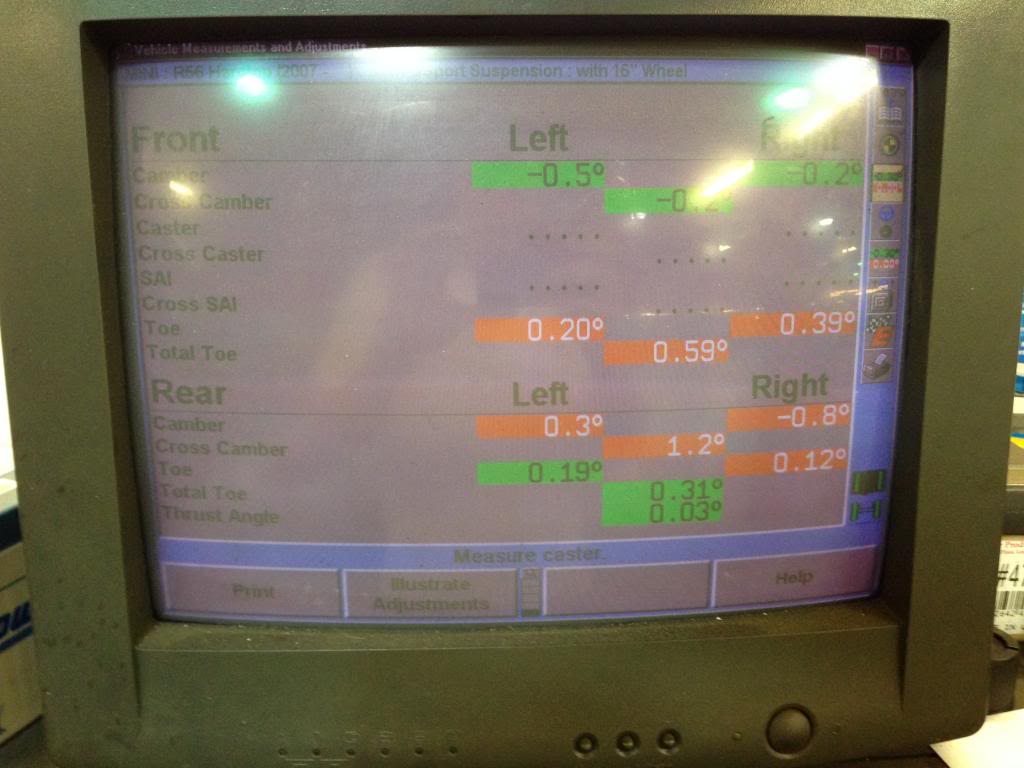

Not to my surprise the alignment was absolutely horrendous.
Gotta fix that.
All better! (The left rear is .1 degrees off and that was about as good as I could get it with the time allotted.)
