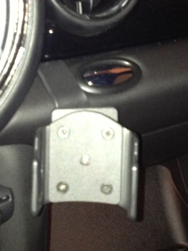

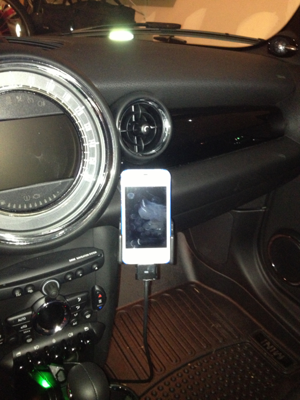

Seriously, and I say this politely to all
The ProClip mounts for the iPhone are the ONLY way to go
We have used them in:
'06 mustang
'08 prius
'97 rangers
'12 MCS R56 wife's
'14 fJCW R55 mine
They have 2 mounts, one for models WITHOUT the upper glove box
And one for WITH the upper glove box
Perfect angle, no glue, no drilling, easy on- easy off
Without phone
With phone
It blocks no controls
And has a super clean look
