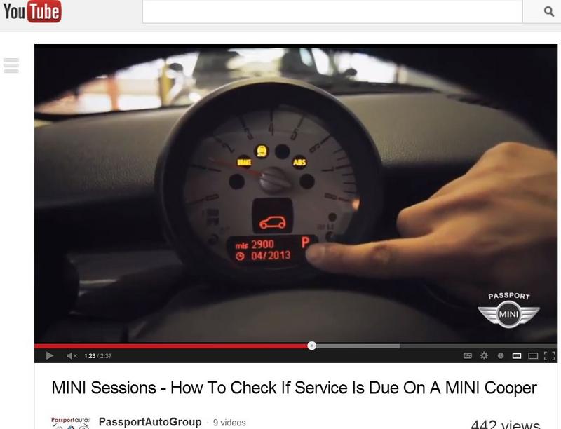

I bought the car used 6 months ago. I am including an image captured from a a how to video on youtube describing how to read the service indicator.

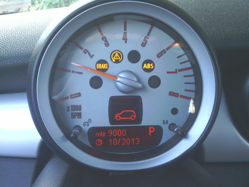

So, I believe I am looking in the correct place. Soon as I turn on MINI an identical indicator comes on as in the attached image. However on mine, the mileage reads 9,000 and six months ago when I bought the car it read 8,000. It is only increasing??!! and by 1,000's?? My understanding is that the mileage indicated in this portion of the reader should be decreasing and gradually so. In other words not in increments of 1,000?

You're looking in the right place. You can look at the details to see what's going on. The procedure is in the manual, but you use the menu to find set/info then service info. Then you can scroll through the individual service indicators.
The oil service just goes down, there is a theory it goes down with gas used. I'm pretty sure we've made it go down faster at times than others. The brake service indicators can quite easily count up if you're very gentle on the brakes, they count down fast for us. The inspection indicator goes down strictly by miles. The brake flush is only by time. The start up shows you the one which is fewest miles away, and the one which is soonest. If its your brakes which are next up, it could easily count up.
