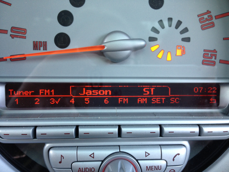

Another issue my mini is having... :( For the first time day, my radio dash board pixels/ lights are fading (picture below).. Also a problem that a car with such low miles shouldn't be experiencing.. I

Have you ever replaced the battery? I have read that odd electrical issues (like your display dimming?) can occur when the battery starts getting old.

The fuses were not blown.. But I bought and opened the new ones.. So I replaced. Since I've had the car (about 8 months) I have not replaced the battery. I just went out and started my car to check the display lights.. And they are still dim but not as bad.. They're coming back to life.. Does the battery charge have anything to do with that? Showing bright at first then fading as your drive continues?
