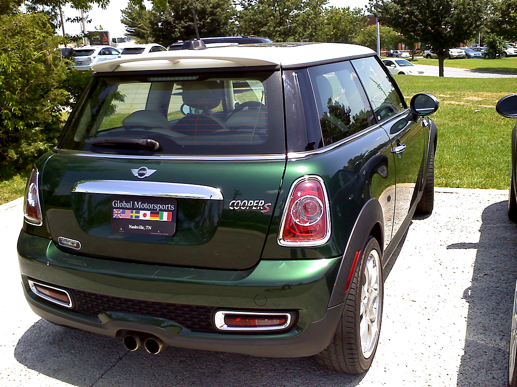

Like I said to the OP just my (Opinion).
And mine did not come from our Local Mini of Nashville dealership.
But it was purchased from that dealer and one owner.
Plus (All) Service Records and still under All Factory Warranties.
Each of us will do what we are comfortable with as it should be.
The OP sounds/reads like they don't have a great deal of (Experience) in this.
Therefore I am just offering some hopefully good advise.
As you can see mine was not purchased from Mini of Nashville by me.
But .........
It was purchased from them by the original owner then by me from Global Motorsports.
It is better to be as Safe as one can be in buying used vehicles IMHO.
