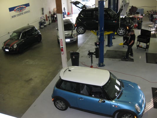

You may want to call or take your Mini to:
MiniWorx Orange County
23192 Verdugo
Laguna Hills, CA 92653
(949) 916-4150
Ask them ^^ what to do if you are not still covered under maintenance.
John's Mini knowledge is vast, his background is impressive, and he drives a Mini too.
