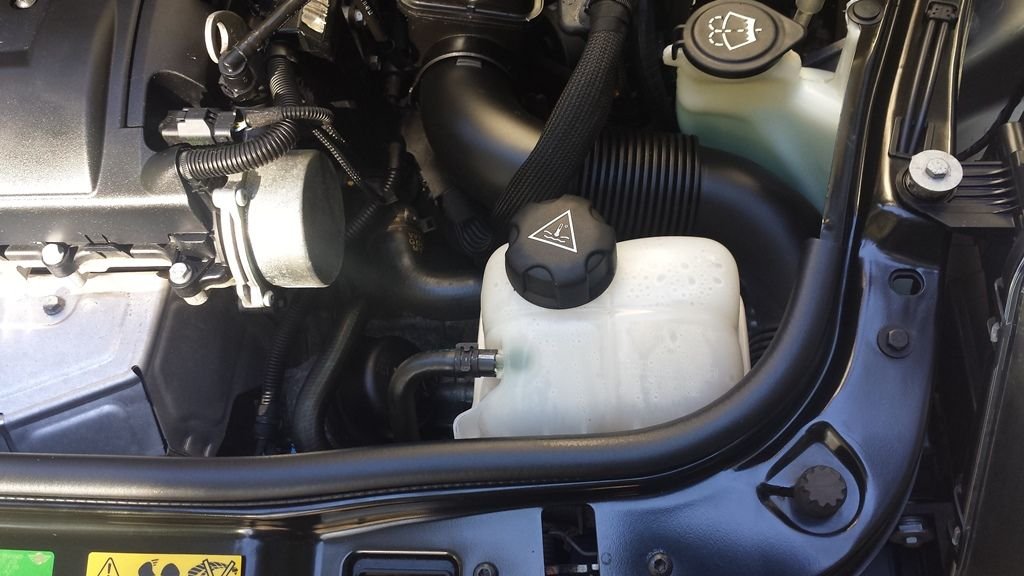

Following are a couple of pics of coolant tank (tank is spotless and trying to keep it that way).
