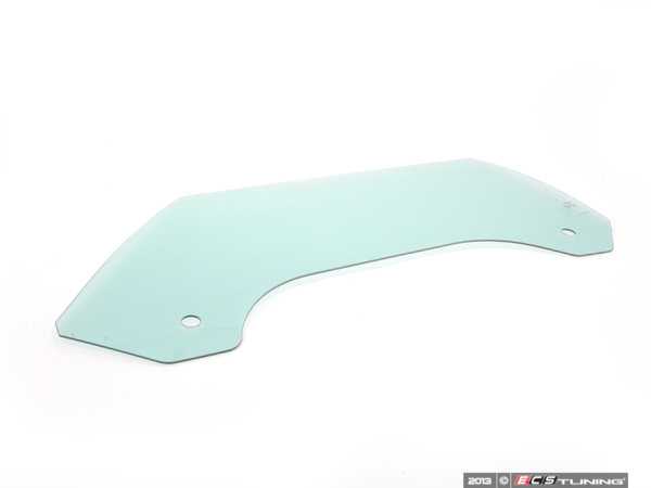

Is the window straight on the gasket from the side. The window itself at the bottom where it meets the window regulator can be adjusted slightly. The window mount on the glass part can be moved around on the mounts by millimeters. Possible it could be off a hair and not sealing with the gasket?
Can you take a picture up close?
Picture of glass.

Just wanted to make sure the widow is aligned correctly , best when its closed and at the seam where you believe its not sealed. Also large Picture of the were the front window aligns with the rear B pillar. That's just in front of the side rear glass.

If your window is straight on the seam with the B - pillar, then you can get a new seal. IF not then you can adjust it with a tool. A MINI dealership or anyone with the ability to align panels can do.
Bpilliar between #2 and #3
For adjustment
*There are two mounts on the bottom of the window at the meeting of the regulator to the glass , they look like little gears and take a special MINI window tool. * Looking at the window on the side of you MINI with the door closed = in essence you can move the window left, right, up , and down by a small amount. But not toward on inward to the car. * Unless you are able to do some mechanicals I would leave this to someone who can repair windows.
Or if its straight: You can get a new seal , we have them here.
OEM MINI Part : 51767151383 Left ( passenger side ) Fits All R50 R53 & R56 hardtops
Thanks and I hope that helps, let me know if you guys need anything else.
