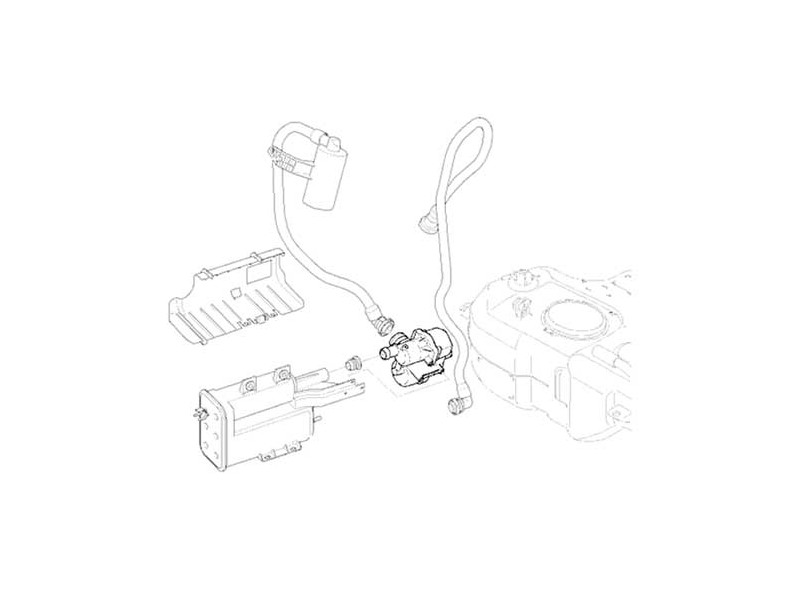

DMTL Leak detected
Diagnostic Module Tank Leakage also referred to as the Leak Diagnosis Pump.
This unit is a little pump/sensor that measures fuel vapor emissions from fuel system. If your gas cap seal is faulty or you have any fuel system pressure leak, this pump runs to maintain pressure in the system. Normally it is not supposed to run. When it runs it sets of the Check Engine light. (One of the potential failures for error code P0456.) I would make sure to check the gas cap 1st.
This is what the picture of the part that is most likely causing your problems.
