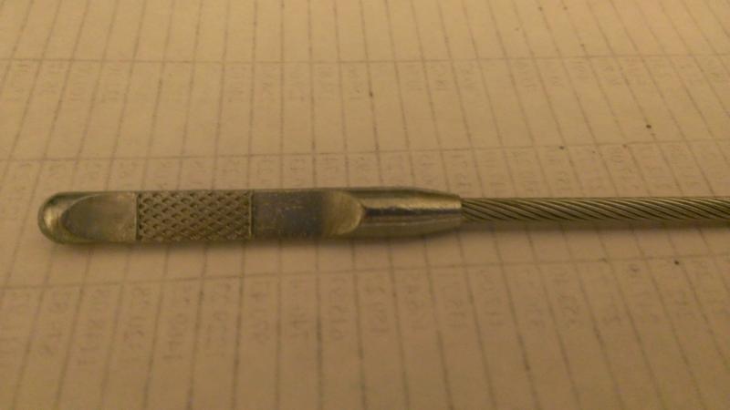

OceanMini2,
My Honda Accord V6 has a curved dipstick path. Honda's dipstick has a flat section of metal attached to the end of a wire cable. The flat section is designed to move through the dipstick tube without binding and because of the wire cable it is very easy to push in and pull out. It is also very easy to see the oil level. This another example of how this problem can be solved.

Originally Posted by byron h
OceanMini2,
Morris, 2011 MC, PW/B
I completely agree that the problem is solvable with a better design.
Mini wants to be different and does not want to be normal. OK, I understand,,, I like my Mini and love that it is not an average car but it worries me because my confidence in the parts and motor longevity is not high. The Mini demands attention and I enjoy caring for it but I hope it does not fail me as many other Minis appear to have for other Mini owners. Sill it is really fun to drive.
When I say I can get a good reading using the OEM dipstick I forgot to say how much research I did to learn how to do it. My hope is that every Mini driver in the world will benefit from threads like this and learn how to solve this problem in a way that is satisfactory.
One time I was at the Mini dealership and a customer was at the service counter. The SA was saying, "your oil level is 2 quarts low....." The customer said, "No it isn't, I check it and I saw oil on the stick." The argument wet on for some time. The customer appeared worried and disappointed anticipating the worst but feeling he was not cause of the problem.
The car company can't prevent every driver from being careless however it is important to satisfy the customer's needs if you want replete customers. Mini ranks high is customer satisfaction but low in reliability categories.

Originally Posted by JoanieB
That's what makes me wonder... Is it the channel itself that dictates needing something on the bottom of the stick so that it doesn't get caught up in the channel? Otherwise, it's only a matter of getting the right length. :-) who is going to go out and tinker with a fix?
BMW/MINI should be ashamed-honda-dipstick.jpg
JoanieB,
This is a picture of a Honda dipstick that is designed for a curved path. It has spherical ends to guide it through the curved dipstick tube and a flat textured surface for reading the level. The end is attached to a wire cable that is very flexible and makes it easy to insert or remove. The reading area is quite a bit below the upper spherical end so that oil wiped off the dipstick tube doesn't get in the reading area. It is very easy to remove, insert, and read.

A flat surface dipstick will only bend perpendicular to the flat surface, thus it can handle one bend in any direction (just twist until it matches), but if there are two or more bends they must all be on the same plane; always perpendicular to the flat surface of the dipstick.
I don't know how the Mini dipstick tube bends internally???
If someone wants a quick and easy way to "help" in reading the OEM dipstick, just sand the reading area with sandpaper to make it very dull. This will allow you to see the shinny oil easier. But it's best to eliminate the lower bulb if you are so inclined. Even the Craven dipstick appears hard to read with clean oil in the photos that others have posted.
I think Mini realizes the somewhat difficulty in reading the oil level and will insure the new 3 cylinder and 2.0L 4 cylinder engines coming next year will not have this issue that many seem to struggle with. We'll see...
