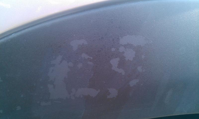

On further inspection of the wheel arches they are indeed peeling not fading. Is there a fix or do I have to buy new arches?

can you post a photo? maybe a somewhat closeup of the part or parts that are peeling? ...is it like plastic that has been scratched off? or are the arches falling off from their mounting points (as if the screws aren't holding the arches on correctly)? ..

I can tell you now that it's the plastic being scratched off. I can get a picture for you in a bit, but the arches are not falling off the car. They are attached firmly to the car. Lol. Sorry if I made it seem like that.

Wow, so somebody wasn't kind w/ their arches! ...maybe something was brushing against the arches, ...like kids bikes (in a garage)? or something. You could take them off, sand the damaged areas, then paint w/a primer that adheres to plastic, re-sand, re-primer then repaint. Doing this will fix the damage, yet they will not look original, as they'll be smoother since you'll have to sand out the peeled areas. If you can afford it and you want to keep them stock looking, i'd probably try replacing them.
They are $95 to replace each one.
http://www.pelicanparts.com/catalog/..._pg1.htm#item2
(you can look elsewhere and may be able to find them cheaper). Oh, check some of the online used auto parts places, ...like salvage yards but online. I bet you can get them for 1/2 that.
if it were just a few tiny peels or scratches then i'd say to try to delicately sand them off... but it sounds like you have pretty severe damage?

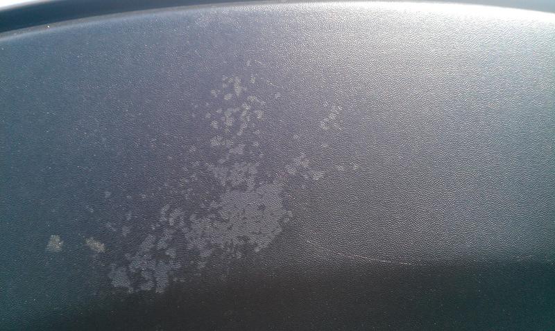

Here are some photos of the wheel arches. Its all on the driver side; both front and rear arches are pretty much like this.

Okay, the photos came through.
That is bizarre, it is as if a coating is peeling off. Mine and other MINI's I've seen look to have molded plastic arches w/ no coating, ..so it is odd that they are peeling. Now I get what you were trying to convey.
I honestly don't have any specific recommendations. You can try Forever Black, but i'd guess that you would see an outline of everywhere they are peeling after applying the forever black. ..it would fill in the discoloration, but not take away the peel effect.
I am wondering if there is a solvent or something that you can use to remove the rest of whatever is coating the arches?
anyone else reading this have any ideas as to what this is and how to fix it??

you know, i wonder if someone did put a coating of paint, or funny enough forever black on them to get them darker? ...and that is what you are seeing that is peeling?
I think you are going to have to find some kind of solvent that is strong enough to remove whatever that is, but gentle enough that it doesn't ruin the plastic OR the paint of your car should it come in contact w/ it.

Looks almost like someone sprayed the arches with plastic dip.....and now it's just doing what normally happens after a while.
Wonder if WD40 would remove PD ?
Anyone try that before ?

How do I go about this trial and error process without ruining the arches even further? If there is something I can try without damaging them even more then I will try it but if there is nothing I will just blacken them with Back to Black or Forever Black and wait until I have the money to buy them possibly one at a time.

As far as replacing the arches, our terriers chewed one of them up on out car and I don't see how you can be getting those spots unless someone put something on the plastic. There should be no coating on them. What I'd try first is get some Meguiers plastic/rubber cleaner/protector and soak them real good with the stuff. Leave it on them real thick for a day or so and see if it helps. If not and you don't want to coat them and want them looking better, buy some new ones. I think you can find them for about $50 each. If you get to removing them, be real careful with the plastic clips that hold them on, they break off real easy, the terriers pulled ours off and broke all the clips. You have to get inside the wheel well, probably remove the well cover which is held on by push in plastic holders, I think only about 5 of them. Once you take the wheel off you'll see real easy. Then you have to get some needle nose pliers or similar and release the hook from the clips from the inside so you can push them out. Don't try pulling on them with the arch or you will break them. Here's the link to parts for your car. http://www.realoem.com/bmw/select.do?vin=tl85368 Get the part numbers and do a search for the number and with a bit of searching you can find the parts. I think I got all my parts for my wheel well at miniofsouthatlanta. The dogs chewed up the well part, the arch had some bite marks on it, but I just left it that way and replaced the well part. Here's the parts you're looking for. http://www.realoem.com/bmw/showparts...23&hg=51&fg=16 the clip for the arches looks like item 10 or 15.

Thank you for the advice. I will try and soak them and see if I can remove whatever is on them. Do you have an suggestions on what type of abrasive cloth to use? Or should I not scrub them and let them soak? If not I will have to buy new ones. It's only two of them.

If you want to rub on them, use scotchbrite or similar. It won't hurt the plastic unless there's a coating on it and then it probably won't matter. The part for the clip if you get the new arches is 07137073915 it's real confusing looking at the parts. Get enough to redo all of them, they're real brittle. I think there's 5 on each side. I looked at replacing the arch, and like I said, I'm pretty sure they can be had for about $50.

Definitely appears to be a coating that is wearing off. Another reason to use Black Wow because this would never happen.
I would take some media reducer and wipe them down to remove the paint/coating. Some 91% alcohol could also be tried. Use a slightly rough towel like a white painters rag. Get them in bulk from Costco.
