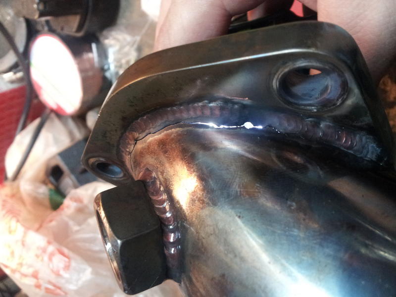

The pics expresses my deepest emotion! Thank GOD! it's a HIGH QUALITY EXHAUST. I had an issue with a CEL that I couldn't find out what it was, I thought it might be a small exhaust leak coming from the obx donut gasket causing the car to lean out so i decided to order a flex pipe to replace the donut (cheap) gasket design. Take the thing apart and what do you know... I had leaks all over the place!!... "huh, no wonder I lost to that 5.0L mustang the other day".... With my friend's help we rewelded everything and thankfully the car is running much better! with no CEL. I regret buying OBX, quality really sucks compared to my Alta cat back.. guess this is what happens when you go cheap on your MINI.. I only blame myself --- and OBX for making a "High Quality Exhaust"...

yeah....well at least now everyone knows that if they feel power loss or a CEL with this downpipe they should take the time and check the welds for cracks. Funny thing is that I only been running this downpipe for about 4 months..

I'll have to go with Porthos on this one. A pipe is a pipe, the difference is quality of welds, piping used, and size. I simply went with OBX because of the price. I was originally going to make my own downpipe, but i didnt want to hack up the stock dp just in case i needed to reinstall it. I also prefer catless and since i am down in Miami, i dont have to worry about smog emissions and what not . I feel most companies over charge on labor for their products, but hey support them if you can. BEFORE INSTALLING THIS DP, JUST SPEND AN EXTRA $15 ON EBAY AND BUY A FLEX PIPE. This wouldn't have ever happened if i had it installed first hand. We live and we learn.
